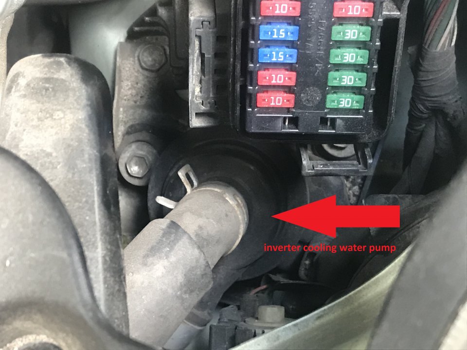

    In the gen 2 forums you'll find this picture a lot. Unplug the circled plug first ... then replace the arrowed fuse.
    With that plug unplugged, if you've got the usual problem, you won't blow the new fuse right away, so you can drive, gently, until you are able to replace the pump that failed. Don't reconnect the unplugged connector until a good pump has been installed.

    Thanks so much for your help. That was exactly the problem I had.
    The dealership told me the combo meter was bad (IT WASN'T)
    It was all just the inverter pump burning out and causing an internal short.

    Use the OEM pump. This was the first one to die on my 2009. I bought it from Toyota Of Prosper and was $150. I guess the Richardson one is closer to you. You can check prices online first and order it. As of today, it is $159 at Toyota Of Mckinney.
