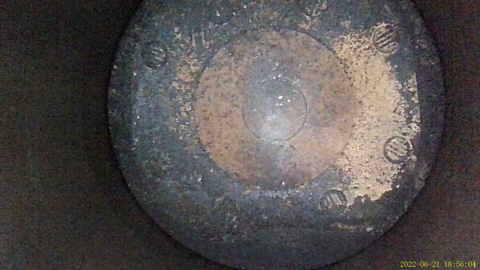

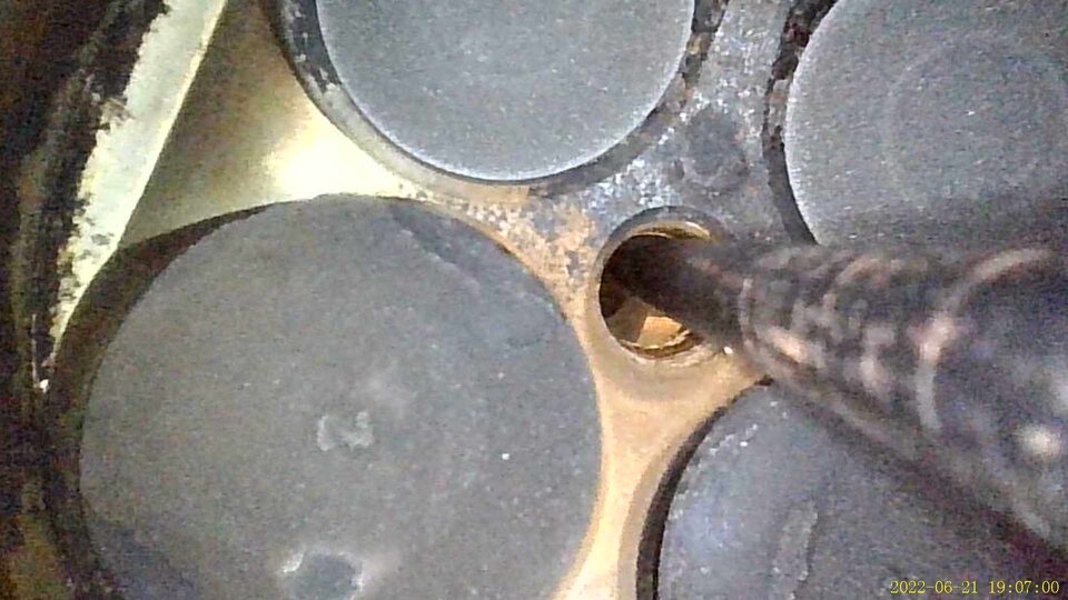

    Hello Prius chat members,
    My wife and I own a 2013 Prius V. Which we purchase new and had 170K miles. At about 145K we had the missing when cold and a good local service shop diagnosed and repaired the cloged ERG. Now we have occasional ratteling on cold start up. On a couple of occations I've check the coolent and observed it a minimum. But it's very irregular. I did the test for CO2 gas in the coolant tank, but the indicator never changed from blue. In the last month I have lost two full coolant tanks with not a drop on the ground. Most mornings it does not rattle. Today I pulled off the wiper assy. Plastic covers and removed the coils and plugs. Using my new Velvor bore scope I've posted what I think is steam cleaning of a piston and cylinder head. Notice the area arround the exaust valves are clean of carbon. This is cyl No. 1. I'd like another voice before I tear this car abart further. My wife loves this car. As far as she is concerened she would drive it another 170K miles. No milky oil. I did get an over heat warning light for five seconds last week when the coolant ran low while driving. There are no other codes. Just the 117 from the temp sensor. Should I go forward with a Head Gasket Job?

    You need to fix it quick. Overheating will warp the head making a gasket repair fail and too much coolant in the cylinders can bend rods or blow holes in the block.

    EGR system clogs, engine overheats and/or heats asymmetrically, head gasket starts leaking coolant into cylinders. Does it seem logical at this juncture, that cleaning the EGR system will stop the already leaking head gasket?

    My coolant loss was random and infrequent but when it occurred my coolant went from hi to low quickly. The last time was headed to the local airport to catch a flight. The engine head light did light up for a few seconds. I made my flight. When I returned a few days to my car I added water and chanced it home. That was point where I did not want to chance it any more. I did my own diy head gasket job. Thanks to the many fine YouTube video tutorials out there I was successful. I did go to some extra expenses . Fel-pro head gasket kit,
    New oem Asin water pump, I replaced all rubber hoses that were disconnected . Understanding the timing was critical. New fel- pro head bolts as well. Luckily I found an excellent machine shop. Take a few photo as you disassemble is my advice. Now almost 3 k later it drives like new. It I had to do it again I would just get a Toyota head gasket set as it’s more complete. Don’t wait on a proper repair as these cars still have a lot of value. Machine shop alone was 250. Add everything else and I spent over a thousand.
