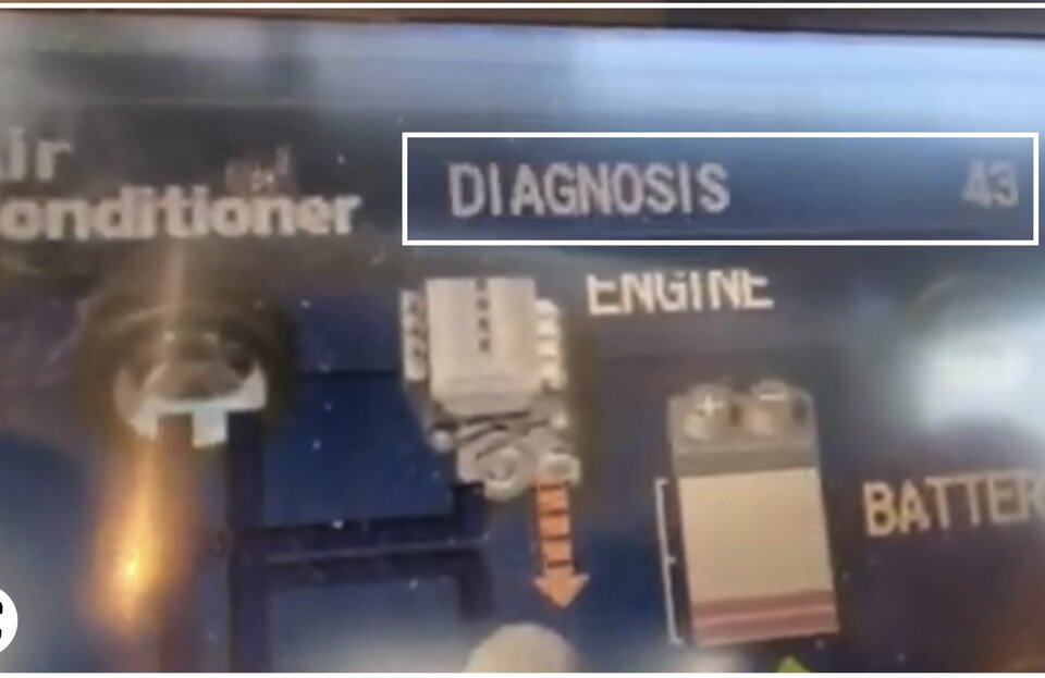

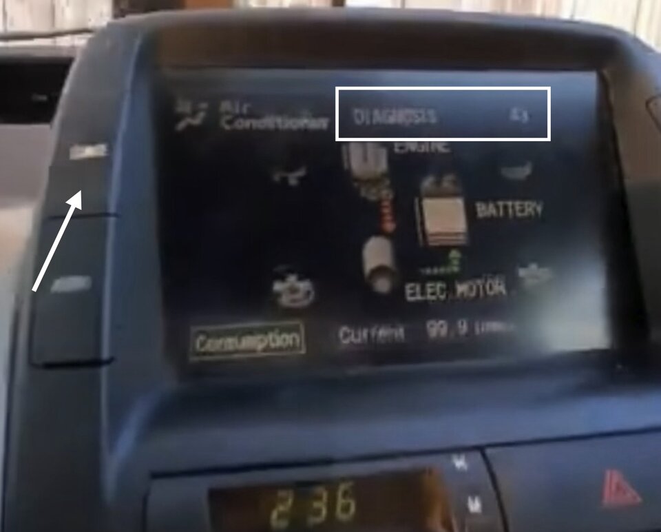

    • Gen 2: Start with the car off. Hold down both the A/C AUTO and FRESH/RECIRC buttons (on the steering wheel), while turning the car on (two power button presses, no foot on brake). Look for two-digit codes shown in the top corner of the MFD. The two-digit code xy usually means the same as a B14xy code shown on a scan tool.

    @rjparker I held down these 2 buttons:
    No foot on the brake. Two presses to the START button. Car came one, radio on, no motor or engine. Most importantly: no codes showing on the MFD. Did this 3 times, even moved the MFD to the CLIMATE screen.
    No codes.

    Try it again as you did it
    Be sure you are holding the steering wheel buttons as you press Start twice
    then press Climate
    Should see a flashing Diagnosis with a number or numbers

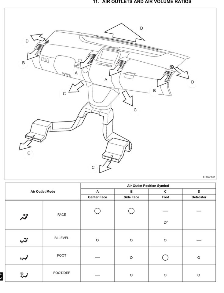

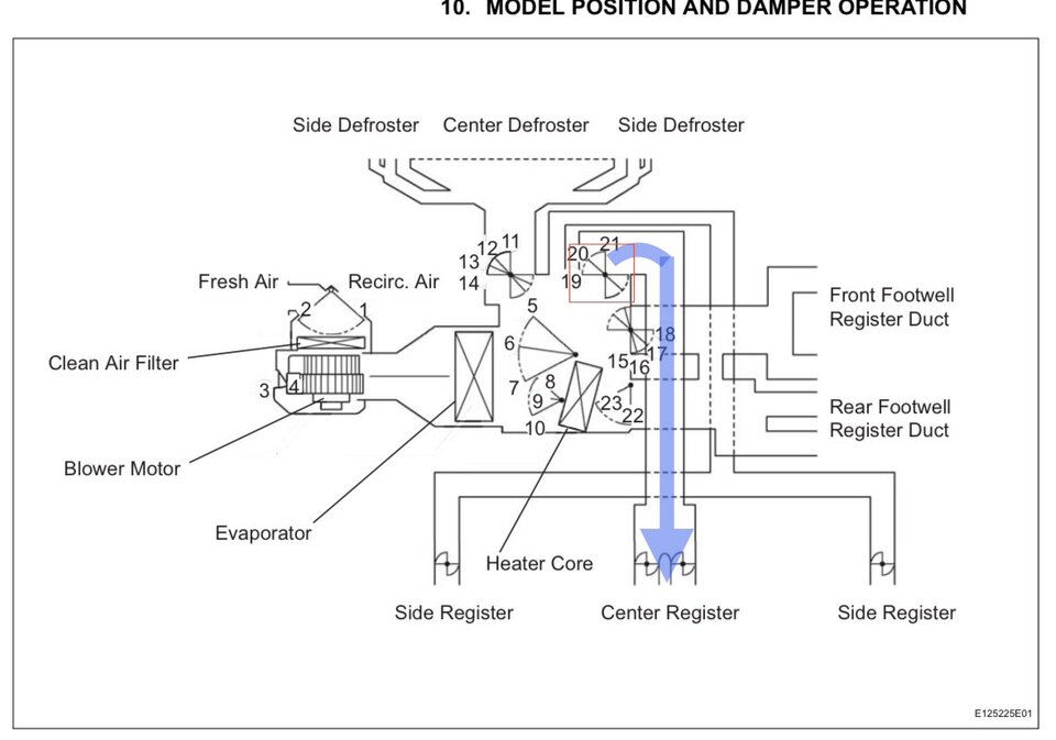

    I would try to find a small hybrid specific shop. Unless the codes point to an electrical issue line a fuse (doubtful) removal of the dash is the standard access. Then its fix linkages or change servos at best or replace air handler at worse.
