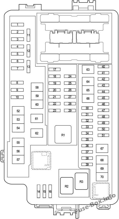

    I have a 2016 Prius. Today I decided to pull the ABS fuse to test the vehicle without ABS and VSC. #62 in the diagram below.
    As expected, I saw a bunch of dash lights. After testing, I reinstalled the fuse but the dash lights were still there. This includes losing power brakes. I tried to clear the ABS DTCs with Techstream but they don't seem to go away. Do I need to reinitialize the ABS system or something?
    62 ABS-MAIN 30 ABS, TRC, VSC
