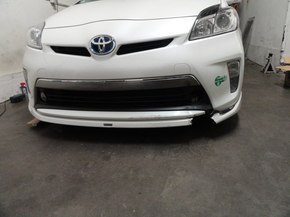

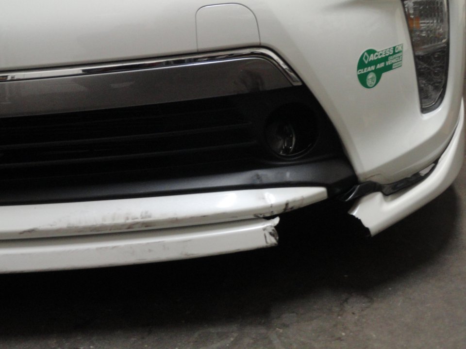

    It pains me to post this pic, but several weeks after the above Video was taken -
    Was driving home on the Freeway and BOOM!! Hit an orange cone in the middle of the Freeway late at night during construction hours :cry::cry::cry::cry:
    Took out part of the lip including one fog light :eek:

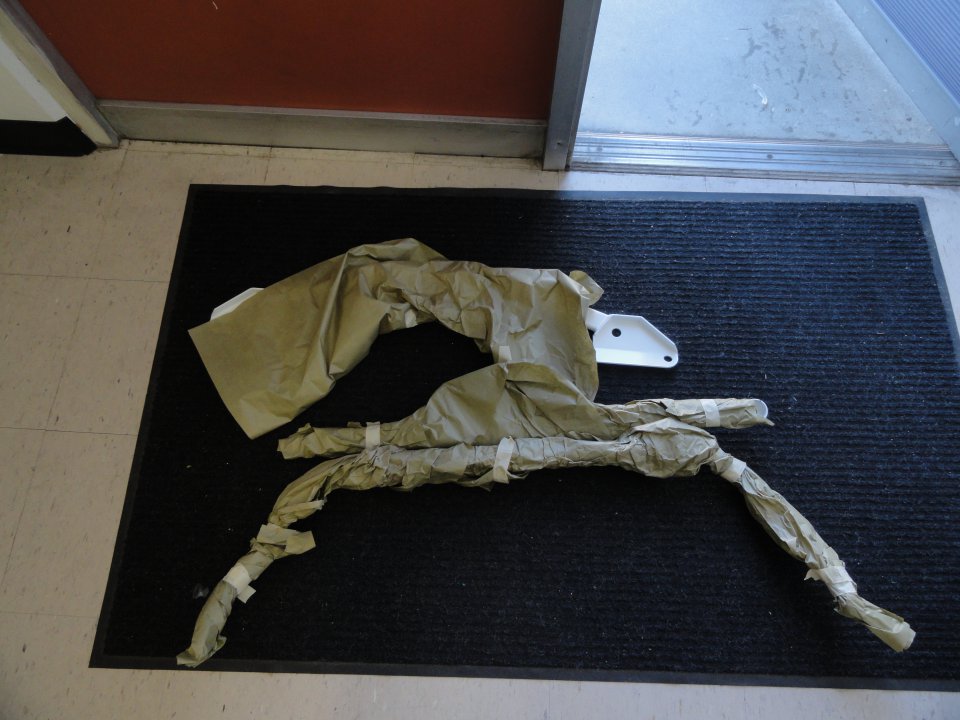

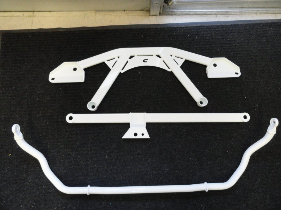

    Now it was time to introduce some Cusco/Tanabe goodies into the picture:
    **Picked up from Primo Powder Coat - wanted to match the color of the TRD Rear sway bar without having the bottom of the Prius looking like a Christmas Tree :D
    Top - Cusco (front center brace)
    Middle - Cusco (front lower arm bar)
    Bottom - Tanabe (front Sway Bar)

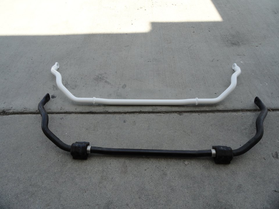

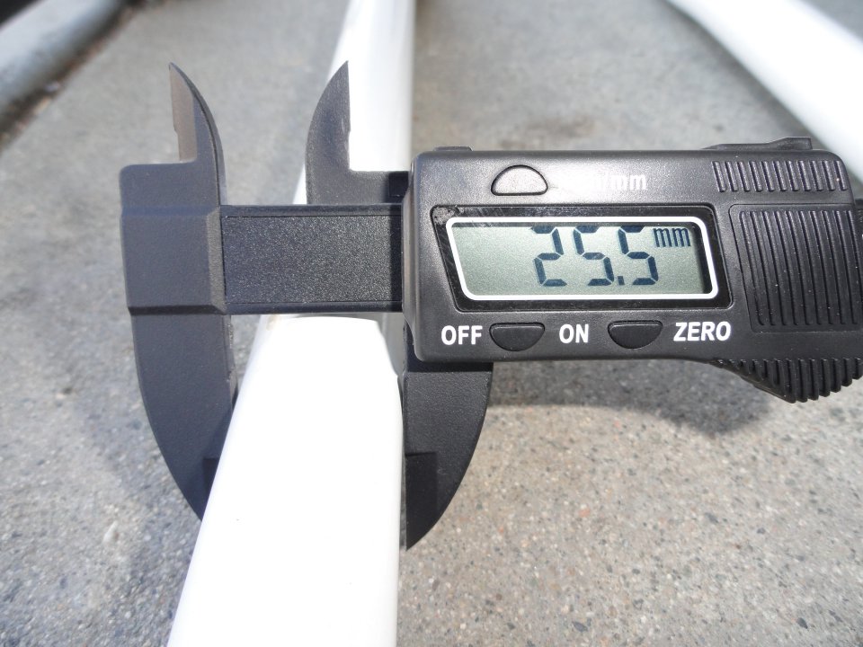

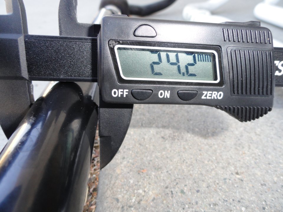

    Tanabe Bar compared to Stock:
    Stock Bar:
    Tanabe:
  14. RightOnTime

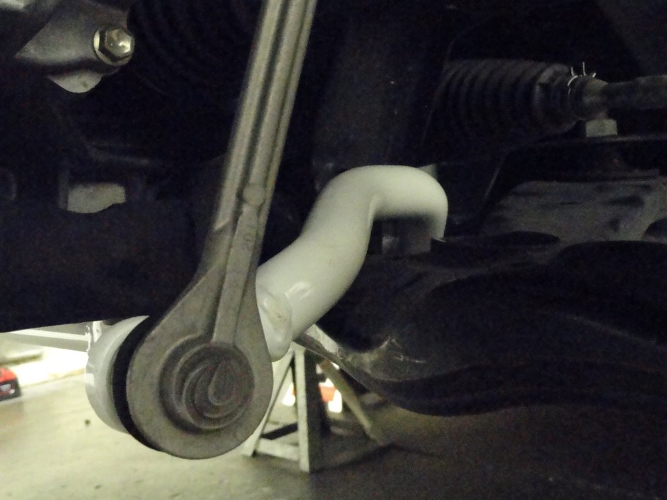

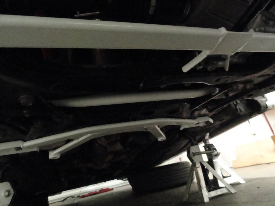

    Took about 2 hours for the install, but i was taking my time to make sure all bolts were torqued correctly :whistle:
    Front Sway Bar installed:
    Burna J and Dylan Doxey like this.

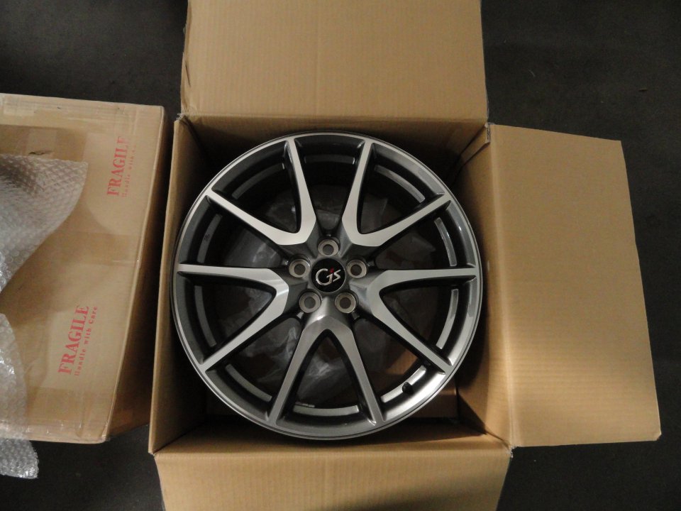

    After 2 months from the cruel casualty of the Orange cone devastating my Modellista lip, it was time to make a decision to buy another lip or complete the full G's conversion o_O
    SO..............................................

    With the above added parts my observations are as follows:
    The Cusco reinforcement bars did help the stability of the car - Especially during high winds but could improve with the the lower rear Triangular bar.
    The Tanabe Lower Sway bar did help out some under steer but not enough to justify the cost of the add on :cautious:
    Overall- After track testing the car for a couple of weeks, my average times got a little slower :( Could it be the thicker Lower Sway Bar that is upsetting the balance of the car? Lets see........

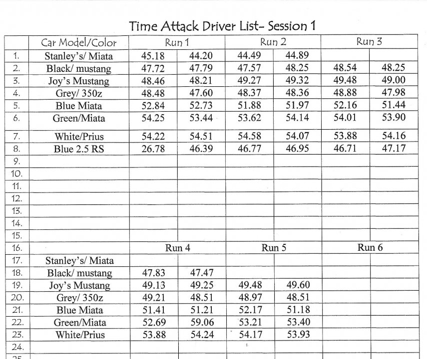

    TRACK DAY @ Adams Motorsports Park
    Following modifications:
    • Modellista Muffler
    • Tein Street Advance
    • TRD Rear Sway Bar
    • Tanabe Front Lower Sway Bar
    • Cusco - front/center braces
