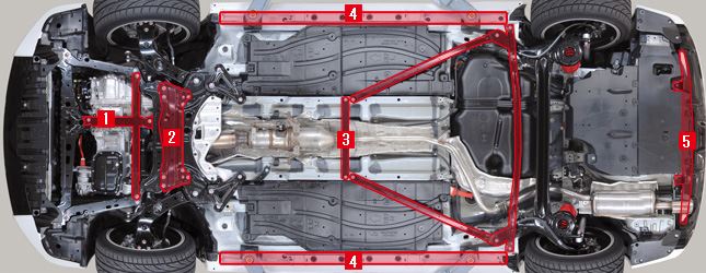

    In order to move forward, I decided to review what the wonderful Japanese Engineers did to modify and improve a stock Toyota Japanese Prius vs a Toyota Prius G's developed by Gazoo racing in Japan :cautious:
    In addition to the 18inch allow wheels and a lower stance, which includes a different spring rate - The highlighted numbers represent the modifications of the Prius G's in relation to a stock Japanese Toyota
    It was just amazing to notice that the US version comes with most of the add-ons except for the complete bar for #3 All this could be due to the stricter regulations that the EPA has.
    1 Front suspension member front end brace
    2 Stabilizer bracket large monolithic structure
    3 Floor center brace
    4 Locker flange spot welding point added
    5 Rear bumper reinforcement
    Why was the TRD lower Sway Bar not added to this modified Prius? o_Oo_O and is only offered as an add-on in the US version. Hmmm
