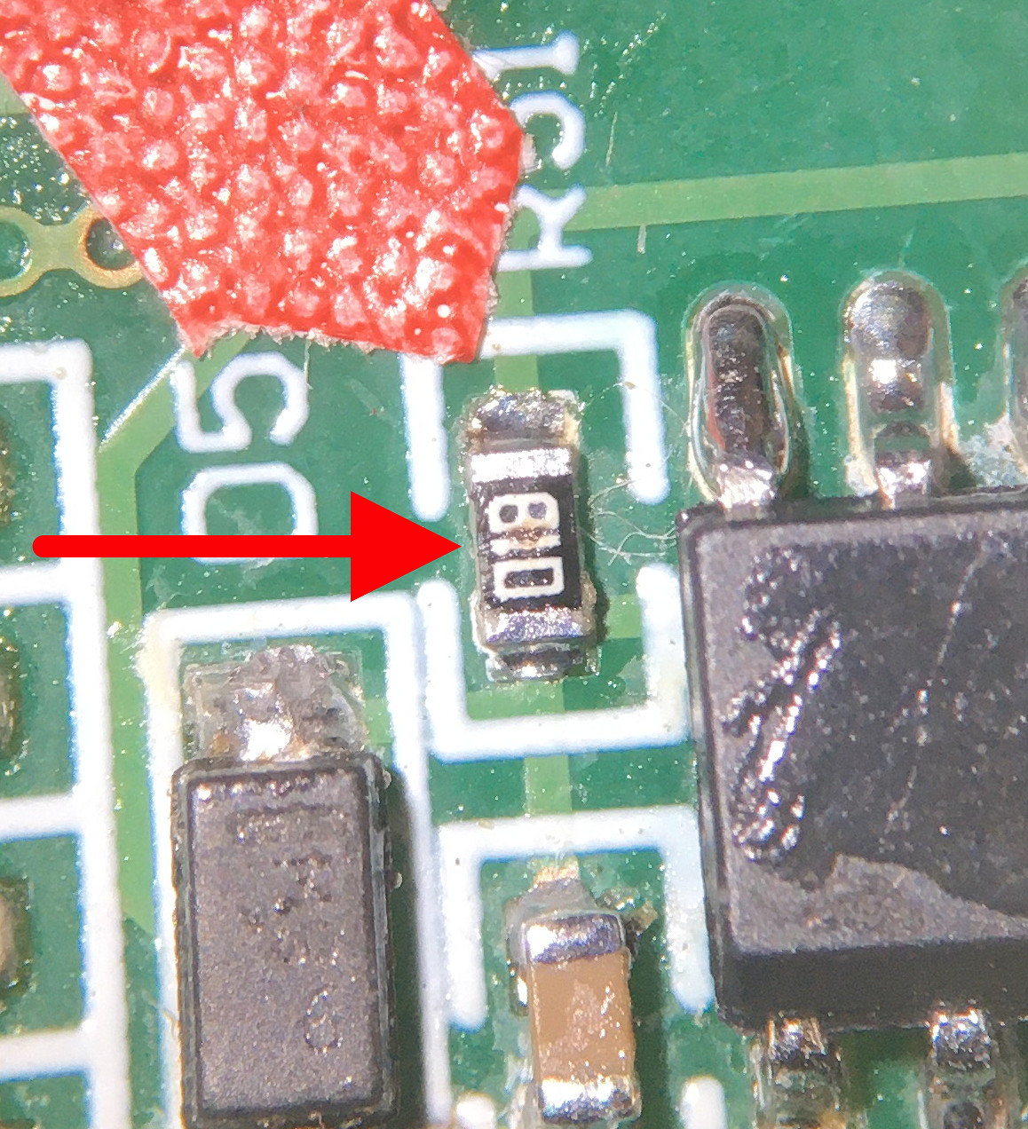

    Here are my Signal Soother benchtop test results:
    As I predicted, the Signal Soother was damaged when the service disconnect was removed while a load was placed on the HVDC bus.
    This test verifies both theories I proposed previously:
    1: Yes, the Signal Soother has no galvanic isolation between the two pack segments when the service disconnector is removed. Therefore, the service technician is subjected to the entire HVDC pack voltage even when the service disconnect is removed.
    2: Yes, the Signal Soother is damaged if any load is placed on the HVDC bus with the service disconnect removed.
    IIRC, the service disconnect also contains the HVDC fuse, so then if that blows out while driving, that condition would also destroy the Signal Soother.
    Fortunately, the failure that occurred when I removed the service disconnect was entirely self contained...
    ...unfortunately, the sparking (across R41 & R51) was so brief that my camera didn't capture it. I repeated this test three times (with replacement resistors) and was unable to capture the spark on film, even at 960 frames per second. It's very fast. For completeness, here's my second attempt, which (also) doesn't show anything:
    Obviously each subsequent test I perform is less and less faithful to the "SS was previously as-found" standard. Ideally I'd test again with another Signal Soother.
    I did physically witness said sparking during each test. After each test both R41 & R51 were visibly damaged, and also measured above 100 megaohms (they were previously 1 kOhm resistors). Here's the original R51 component after my first test (R41 looked identical):
    During my third test, I placed a high speed differential probe across D5, which is in parallel with the 'V5' opamp, and also a 100 nF capacitor. I had this probe set to trigger on a rising edge at 39 volts. When I repeated the service disconnect test, the probe did NOT trigger. That means the 36 volt zener diode is heroically shunting ~216 mA ([252 - 36] / 1000 ohms), which is ~61 times it's nominal 3.5 mA rating. This means the voltage rail driving this opamp never exceeded 39 volts, which means the opamp probably isn't damaged.
    Note that the opamp's Vabs(max) is 36 volts, so technically we exceeded its ratings... but both opamps (V4 & V5) worked again each time after replacing the 1000 ohms resistors. It's possible there is residual die damage to these parts, which is difficult to test for without a much larger sample size (because internal high voltage part failures don't always immediately present themselves). However, I didn't observe opamp failure during my testing; only damage to the high-side 1000 resistors.
    If someone else wants to send another Signal Soother, I'll test it again on the bench. Of course, anyone with the Signal Soother still installed (why?) can easily verify my findings by removing the service disconnect and then attempting to start the car.
    Here's how the Signal Soother behaved before and after each test (results were identical all three times):
    Blade# | deltaVout (before) | deltaVout (after) | circuit damaged?
    B1 | 18 | 18 | No
    B2 | 18 | 18 | No
    B3 | 18 | 18 | No
    B4 | 18 | 0 | Yes, R41 visibly damaged, measures above 100 megaohms
    B5 | 18 | 0 | Yes, R51 visibly damaged, measures above 100 megaohms
    B6 | 18 | 18 | No
    B7 | 18 | 18 | No
    B8 | 18 | 18 | No
    B9 | 18 | 18 | No
    B10 | 18 | 18 | No
    B11 | 18 | 18 | No
    B12 | 18 | 18 | No
    B13 | 18 | 18 | No
    B14 | 18 | 18 | No
    These results are unsurprising. When the entire pack voltage is applied to each opamp circuit on the signal soother, the 36 volt zener diode clamps each opamps' voltage rail, which caused 216 volts (252 - 36) to develop across both R41 & R51. Each 1 kOhm resistor therefore briefly sinks 46.6 watts, which exceeds the nominal power rating by ~375 times (hence why I saw them flash during each test).
