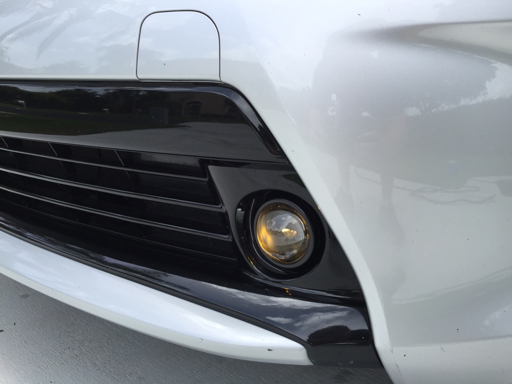

    Installed, thanks Cheizy!!

    Looks great! Yellow bulbs?
    I have Nokya 2500k bulbs in mine.

    Yup in parking lights and fogs. Yellow helps me allot at night in the rain

    OEM headlights are 4300K to 4500K, or warm white. You'd call them yellowish.
    Cheizy has 3000k, which is definitely yellow, see first post for pics.
