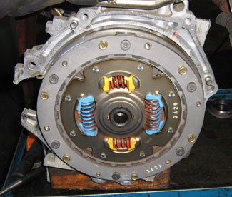

    If you have really listened to what the man had to say around the 6:00 mark you would have heard him saying loud and clear that the ring plate applies constant pressure to keep the "clutch disc" always applied. In other words the "clutch" is never disengaged.

    So called cluch is the torque limiter between ICE and PSD in reality. There is not and active part to disengage the clutch.

    Toyota calls that the torque dampener. It's not a clutch.
    Edit: More correctly the "Transaxle Damper" from Toyota Technical Training / Toyota Hybrid System Diagnosis / Hybrid Vehicle Control Systems Section 4-5.
    "A coil spring damper with low torsion characteristics transmits the drive force from the engine. Also, a torque fluctuation absorbing mechanism that uses a dry-type single-plate friction material is used."
    "On the '04 and later Prius the spring rate characteristics of the coil spring have been reduced further to improve its vibration absorption performance. Also, the shape of the flywheel has been optimized for weight reduction."

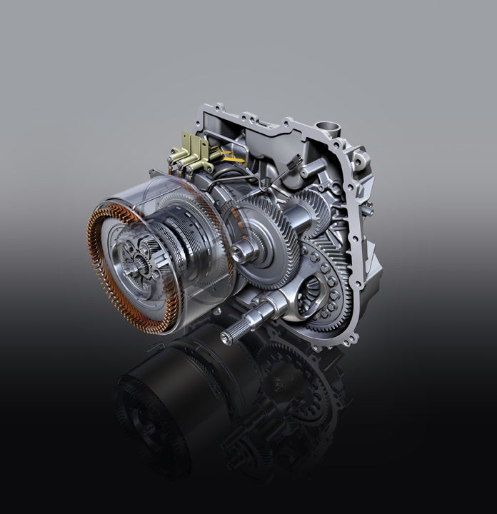

    This is the Volt's torque damper along with 3 additional clutches.

    No, the torque damper (or clutch if you want to cal it that) does not disengage.
    Call it what you want, but it does not disengage the ICE from the PSD. It is a damper to reduce vibration and shock loads on the trans-axle.

    Absolutely.
    Volt:
    Prius Gen2 (left) and Gen3 (right):

    99% of mechanics would call the "Transmission Input Damper" a clutch if you brought it to them and asked what it is. Typical clutch with friction disc, flywheel, pressure plate etc. It transmits power from the engine to the drivetrain, definition of a clutch. The amount of slippage is controlled by the pressure plate, definition of a clutch. It allows the crankshaft to rotate independently from the output shaft via slippage, clutch. The "Torque Control Clutch" (SAE terminology) is called a "Transmission Input Damper" by Toyota. It's still a very typical friction disc with pressure plate, therefore it's a clutch.

    This clearly never happens in the Prius. So therefore people were incline to provide a correction. However, yes you are correct that it is a clutch, even though it does not "disconnect" anything.
    In my line of work, I would call it a torque limiter before calling in a clutch, only because most people commonly think of clutches as engaging or disengaging something. But a torque limiter is a clutch, just not the garden variety one.

    You are absolutely correct that the transmission input damper contains a permanently engaged friction clutch. In that respect the Prius does contain a single clutch. However, no knowledgeable person would consider the transmission input damper a clutch in the control sense of the word, which is how "clutch" is normally used in the automotive world. The damper is a safety device which allows slippage in extreme conditions. Generally automotive engineers avoid calling this a clutch to eliminate the confusion found in this thread.

    You can certainly call it a clutch if you want, and technically you would be correct. The problem is when you use such a generic term you confuse people, including yourself, into thinking that it can be disengaged. A clutch is a mechanical device which provides for the transmission of power (and therefore usually motion) from one component (the driving member) to another (the driven member). However, most people think of a clutch as something that can be disengaged. A Torque Limiter is specific type of clutch that in this case cannot be disengaged.

    To be fair, the Volt picture includes the differential, while the Prius pictures don't.
