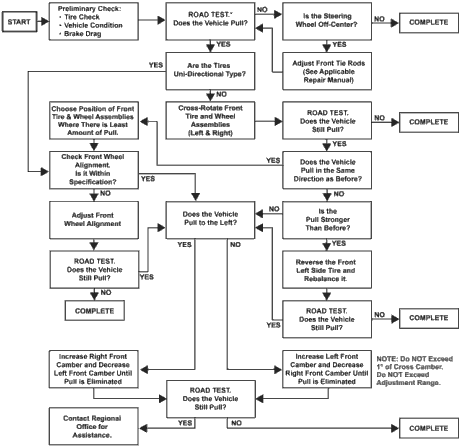

    Last year I installed new shocks/struts assembly, new inner/outer tie rods, new sway-bar links, got an alignment and it's been pulling to the left after that. I've had an alignment 4 times since and it hasn't fixed the issue. Yesterday I installed adjustable camber bolts and got an alignment, still the same thing pulling left. Tires have been ruled out as its never pulled before the new shocks, and I've also rotated them and its still pulled left.
    Anyone have experience with similar issue and what was your culprit? All I could think now is maybe one of the shock assembly was bad, or maybe the brakes are sticking, or maybe one of the bushings or joints are bad. It's a 2012 plug-in with 159k miles. Let me know if you had similar issue and what common culprits are for 3rd gen.
  2. ChapmanF
    28,124
    18,604
    You probably want to take a look at T-SB-0063-20. It's where this flowchart comes from:
