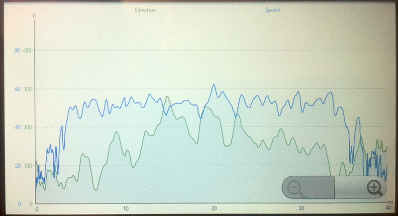

    Re: Pulse and glide at higher speeds (66 ~ 68MPH) beats super highway mode at lower speeds (50 ~ 55M
    Well the OP hadn't discussed the MPH of interest. The above guide holds from 45 to 60 mph.
    Actually I got 70 scangauge mpg highway to highway (miles 4 to 35) on this rather hilly trip to DC, Average speed from measurement to measurement ~50 mph. Obviously scanguage MPG is not entirely trustworthy, but I think the strategy you see in the graph below and was outlined to the OP in my previous post is superior to IGN for this sort of terrain.
    60@60 on hilly terrain should be possible on this, but not with IGN measurements.
    My guess is that 65@65 on more mild terrain might also be possible using 15.0 kW pulses and 8.0 kW "glides".
    It would be awesome to have a plot of kW alongside this, but I haven't found any developer interested. These apps are mostly written for bicyclers and hikers.
    So I think there's a misunderstanding here. I wonder if your 60@60 projection assumes that all of the energy of the ICE is lost. But as we know it isn't, it is stored in the traction battery.
    Overall car efficiency can be higher than 60@60.
    Just today I got [email protected] on very hilly terrain with A/C at 77. I'm pretty certain that the would do better in absolutely flat terrains. If you're interested in my measurements and trip or have any suggestions have a look
    http://priuschat.com/forums/gen-ii-...ix-mile-highway-trip-flats-hills-results.html

    So are these numbers that you mention empirically derived? Do they take the contribution of the inverter-derived kinetic energy into consideration?
    So far I have gotten 70@54 and 62@61. There definitely seems to be a significant fall-off. Well, I'll be doing the identical trip next week again. I think I can get 55-58@65, but maintaining that average speed is tricky because the speed limit is 55 in some parts of the trip.
    I will test the first 60 mile hills @65 mph
    And I need an app that also tracks instant kW output and impg, then we can talk more scientifically :) I don't think I claimed 65@65 on an uphill, but I do think that with ideal hills (sharp uphill, protracted downhill for WS) the Prius can do better than 60@60.
