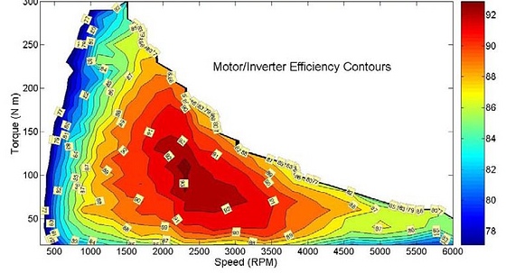

    The short answer is: Yes, in the context of hypermiling, pulse and glide in EV mode is more efficient, but only at very low speeds.
    The long answer is:
    Looking at the efficiency diagram of the Gen II below for example, notice that the main electric drive motor generator (MG2) has its best efficiency in the medium power range. Although not as bad as with the ICE, the efficiency at very low power output is clearly less than at medium power output. This leads me to the conclusion that the pulse and glide technique during EV mode, using an EV pulse without the ICE, would be more efficient than steady power during EV mode under certain very low speed conditions.
    Combined MG2/inverter efficiency, Gen II Prius
    I realize that it is generally more efficient to use the ICE pulse when possible, but there are some rare circumstances when an ICE pulse is not desirable, or it would have to be pulsed so briefly that it uses more electricity to start the ICE than would be used to propel the car directly with electricity. I also realize that the possible improvement in gas/e mileage is probably so miniscule that it can be neglected, with the possible exception of hypermilers. This is more of a theoretical question than a practical one for most people.
    The battery, on the other hand, has a worse discharge/charge efficiency at higher power levels. This counteracts the good efficiency of MG2 in its optimum range, and shifts the optimum combined efficiency toward the lower midrange of motor power.
    So, when EVing at very low speeds such as in parking lots or ins very slow traffic for example, it can be more efficient to do a moderate EV pulse, and then glide, rather than to EV with constant very low power (traffic permitting of course).
    Also along this line of thought, under certain conditions pulse regenerative braking can be more efficient than very light steady regenerative braking.
    Since the efficiency curve of MG2 during generation is somewhat similar to that of during motoring, moderate regenerbraking can be more efficient than very light regenerbraking. This has been measured and documented, for example by Attila Vass. (The new 2004 Toyota Prius : How to brake)
    For example, when driving down a long, gentle slope, where very light regenerbraking would be necessary to remain within the speed limit, it might be more efficient to glide (no arrows) and periodically regenerbrake moderately, rather than to regenerbrake very lightly the whole way (traffic permitting of course).
    Naturally, there are many other factors affecting total efficiency, so that it is hardly possible to calculate it exactly from just motor generator and battery efficiency. Actual driving measurements are necessary.
    And once again, to be perfectly clear, this question has little practical value for most people, and I am not necessarily endorsing or encouraging pulse and glide. But it is a technically interesting question for hypermilers.

    In regard to the Prius, this statement has a fundamental flaw. The problem is the lack of a variable transmission between MG2 and the drive wheels. Looking at the efficiency plot of the combined Inverter/MG2, it is easy to see that they are less efficient at low speeds, which is why one might jump to the conclusion that P&G will help for very low speeds. However, when you pulse at very low speeds with MG2, lacking a variable transmission, MG2 is forced to run at the low, inefficient speed.
    With conventional gas engine P&G, the transmission allows the engine to run at an efficient speed when pulsing. Not so with MG2.
    If we want to be pedantic, we can show that at very low speeds we improve efficiency by driving faster. Therefor we gain efficiency at the high end of the pulse. That part is true, but once you take that to its logical end, you realize that the longer the higher speed pulse the better the efficiency; in other words, drive faster. Using our pedantic argument, to drive 10 mph to the corner store efficiently, we drive the entire distance in one 20 mph pulse, then sit in the car for the same interval at zero. I suppose we could call that P&G, but it would be silly.

    Yes, if the efficiency of the electric drive were only dependent on the speed (rpm), then pulse and glide wouldn't help. But the efficiency also varies with load, or torque. The efficiency contour in the example above shows that under around 50 Nm, the efficiency decreases significantly.
    At low speeds, the amount of torque required to maintain a steady speed on a level road is well below this level. Short pulses at the same rpm but with a higher torque of above about 50 Nm yield a better efficiency.
    Fred
