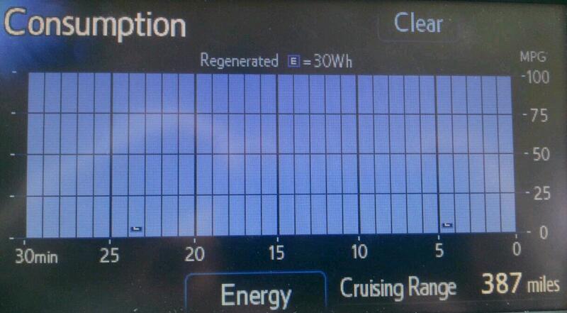

    You can watch the MFD for indications of good pulse and glide technique. This is from my Model Three since I never bothered to do it in the PIP. Same general rules apply, however.
    Perfect P&G
    Not so perfect P&G
