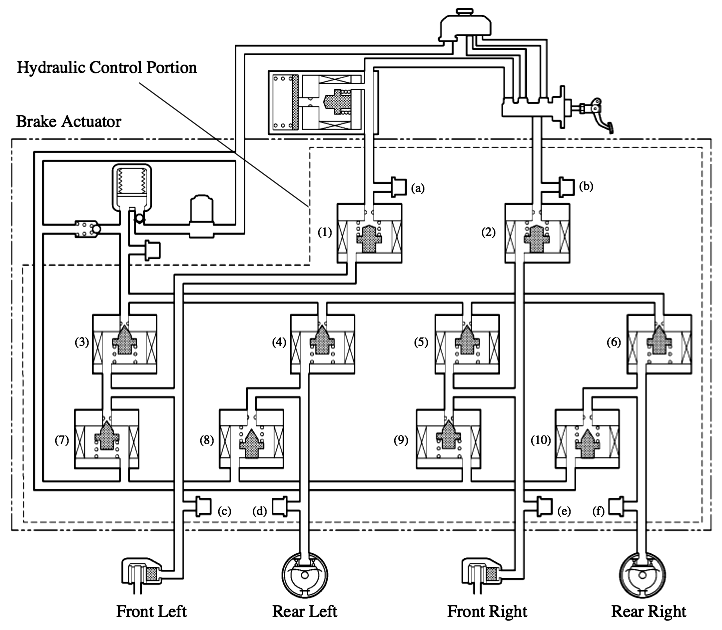

    Mushy brakes got so hot they boiled and have air in the lines. If it was me, I would bite the bullet and have the dealer bleed the brakes. They have the software for that, it will be a lot of fluid. Prius brakes are complex.

    NOW you tell me, Jimbo. :LOL: Prius brakes are complex? I don't doubt that, and they seem good in every-day normal driving. Breaking "gently" is doable in Southern Ca traffic, but the long "glide slopes" I find to be impossible, in busy traffic.

    This is from a Gen 2 not a Gen 4, but you get the idea, all 10 of those relays need to be in the correct position to bleed the brakes.

    Holy Smoke! Definitely complex. Thanks, Jimbo.
