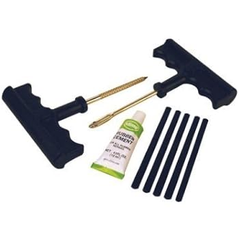

    This and a pair of pliers will handle almost any puncture in the tread area if you carry a mini air compressor. Check the little trunk for the Toyota flat kit anyway. You should find a bottle of Toyota slime and a Toyota compressor that only works when connected to the bottle. If you ever go that route, you'll need to have the tire serviced and the TPMS valve replaced.

    Could you provide a link to the flat repair picture please.

    I'm having some trouble posting the Amazon link, (maybe it's not allowed?). Anyway, it's the Slime 1034-A T-Handle Tire Plug Kit. Similar kits are generally available.

    That works, thanks

    One other thing missing in the repair picture is a pair of some kind of pliers to remove whatever is stuck in your tire.
