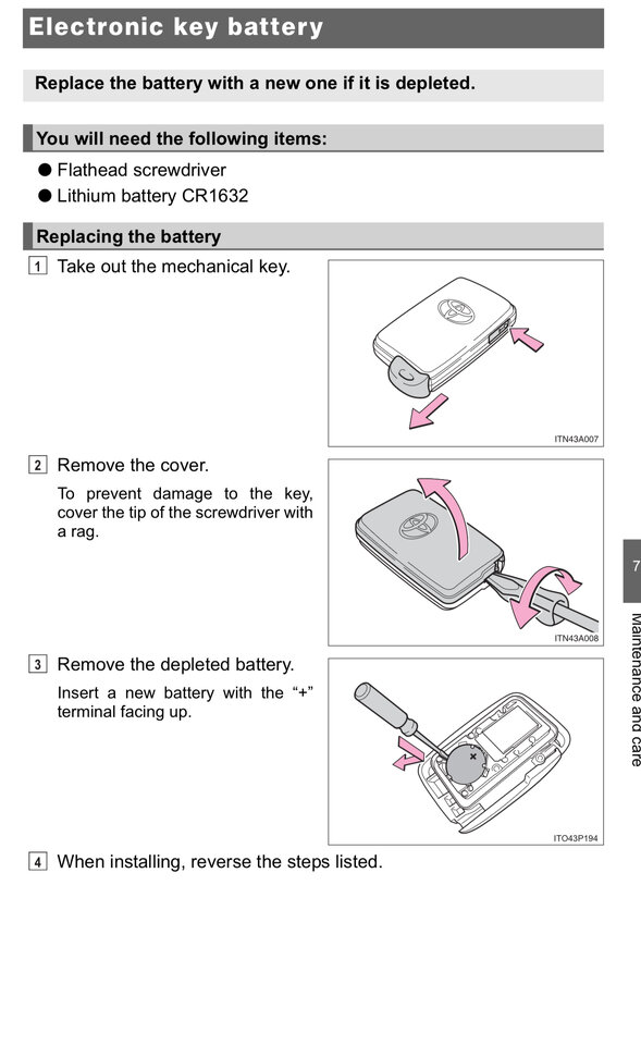

    Depress and hold brake and one Power Button press should bring up Ready iin a second or two. The engine may not start. That is ok. You just need Ready to drive.
    Otherwise something is wrong. I would check with your second fob. If you don't have a second fob, get one right away.
    I would change the fob batteries as well. Page 459.
    IMG_0359.jpeg Check the owners manual page 172 on how to start the car. A dead fob can Ready the car by holding it on the Power button and then press the button with the brake on. No manual? Download from toyota,com.

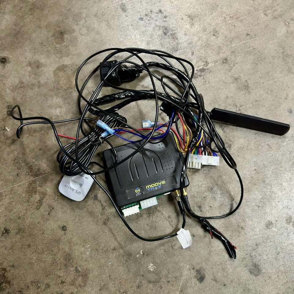

    So it was this Moovetrax device the previous owner had installed. Pulled this mess out and of course the factory wiring was a little hacked up, not much else I could do. Now it starts on the first press of the start button.

    Guess he wanted it back...
  8. Mendel Leisk
    61,572
    42,361
    Might have been imposing a phantom load too; good riddance. (y)
