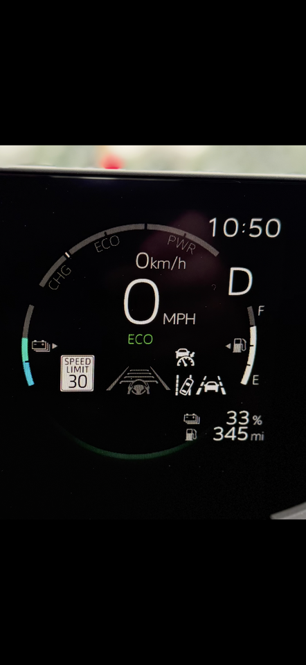

    I attached a close-up picture of my ‘charge-evo-power’ meter (on the upper portion of the picture). Notice how both the ‘eco’ and the ‘power’ sections have a half way through position with a notch. I’m guessing that if you get past the 1/2 point in the power section, that is when the engine will turn on.
    Later today, I am going to try it out on my 2025 model. I should note, my car is in EV mode.

    I am not familiar with the Gen 5 display (darn, it is small and cramped!), but no, that cannot be. As discussed here, in the BEV mode (not in the BEV/HEV auto mode), the engine would not kick in no matter how much you press the accelerator as long as you are under 84 mph, except perhaps in unusual circumstances such as an overheated or too cold traction battery.

    The maximum power you can ask for in EV mode is 75%. Try it.
    Power demand is limited to 75% even if the engine is running!
    That never happens in EV mode. Full pedal travel won't enter the last block of 25%.
    Any engine start will be due to some other condition, such as the system feeling the battery can't currently supply the full 75%.

    I am in complete agreement. It is what I found myself last night driving my new 2025 version. I am amazed at how strong you can push the EV motor/battery and not see the engine come on. In my 2012 model you had to be very careful when in EV mode or you’ll start up the gas engine. I much prefer my newer model: Much more available power in EV mode (it feels like a sports car to me) :)
