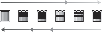

    I was reffering to this:
    FULL upload_2014-9-19_23-6-43.png EMPTY
    Your battery indicator does change to bars when battery is running out, does it?
    markabele likes this.

    Right, but it still looks like segments to my tired old eyes, although they are more pronounced in the EV battery level indicator.

    It's a low resolution display. Actually, your eyes are still sharp enough to notice pixels wich form the "solid" picture of a battery. (y)
    You outperform your PiP! ;)
