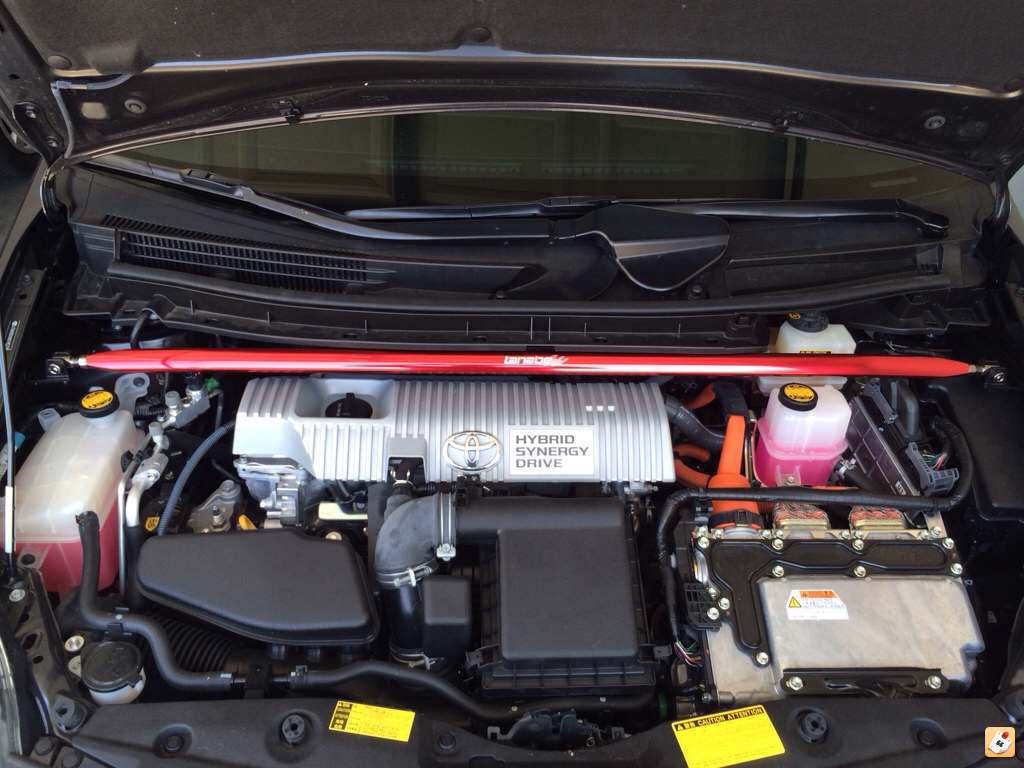

    I installed mine last night and I am extremely disappointed at the installation and fit. I think it was really stupid of tanabe of designing a product like this.[​IMG] As you can see the fuse box is blocked. The first fuse that pops this part will be removed and thrown away!

    Something I realized is its a ultimate sacrifice because of the design. Put it in, and forget the fuse box <cough>, until you need to get in there.
    If I were doing this again I would look into the cusco brace.

    After testing mine I can truly say it does help and I noticed a big difference at both parking lot 5-10 mph, dips u-turns and highway speeds, braking and acceleration also feels symmetric due to suspension work applied to the shocks instead of the chassis/subframe.
    The Tanabe Brace does work, however it obstructs the fusebox and coolant reservoir.
