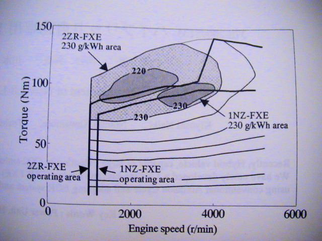

    OK, you are correct that the EV dash light indicates that the engine is not running. EV Mode on the other hand is a suggestion by you that for some reason (not polluting downtown, sneaking home with out the wife hearing the car, reparking in a parking lot, etc.) you want to override the computer's judgement on how to best get good gas mileage.
    In most scenarios, it is more fuel efficient to use the engine to propel the car than to use the battery to propel the car and then use the engine to recharge the battery. In some low speed scenarios (up to about 40, I think) there can be scenarios where the engine is so lightly loaded that EV operation may be more efficient, as recharging later will be a higher load for the engine that is more efficient. All power in the car is ultimately from gasoline, so the fewer number of conversions of the energy in gasoline to other types of energy, the better.
    I do not have a graph for the Prius c, But this graph shows how high an RPM the Gen 2 Prius was most efficient at. (Lowest grams per kWH) lower engine speeds than that were not as frugal.
    B is NEVER more efficient than D, it just keeps the friction brakes cooler, which can help on hills that may otherwise overheat the brakes.
