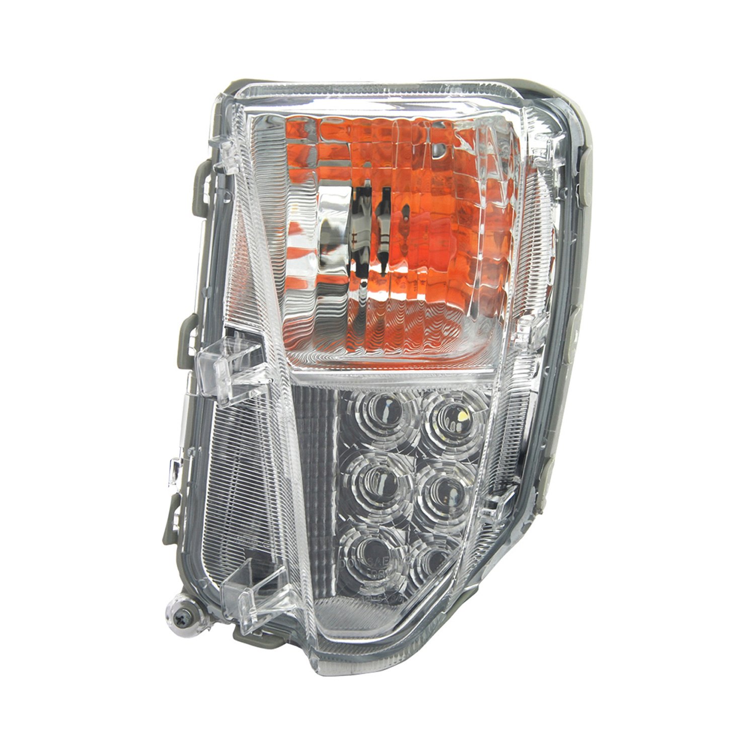

    Needed to replace my front bumper on my 2011 Prius after getting into an accident. I purchased a 2012 bumper without realizing that changes Toyota made. I read the post from 2016 about the retrofit. My question is if I don’t care about the daytime running lights working or having fog lights. Is there a way to use a 2011 turn signal or can I upgrade to the 2012 daytime running lights and just only use the turn signal function?
  2. MagnusAG99
    MagnusAG99 Senior Member
    Feb 21, 2017
    671
    516
    Norway
    From what i know, the turn signals with the DRL function use identical bulbs, so it should be plug and play with installing the face lift turn signal on it (if you eventually want DRL to work, then that will be a bit more work tho). If you start messing with adding the 2011 blinkers on it then oh boi... Thats gonna be h3ll alot of work lol, also, if you have foglights on your 2011, they should fit on the new bumper as well.
    These are the lights you need.
