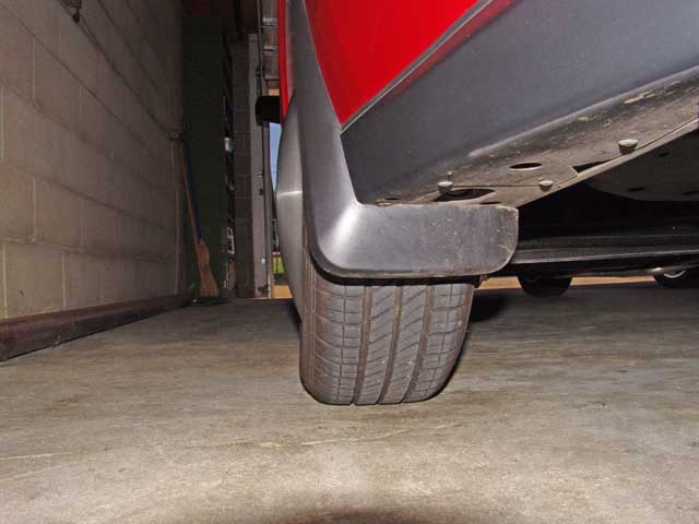

    Finally took a picture of my mudguards and my caps. Mudguards should not be a problem with hurting fuel mileage because the caps push the air around them. :D But i dont care about that anyway. The mudguards and the caps look good and that all I care about.
