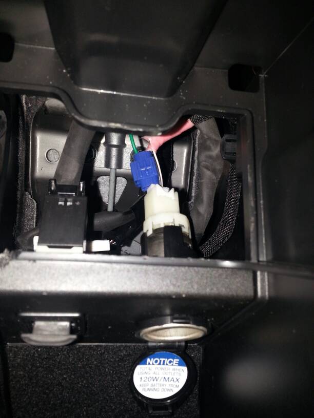

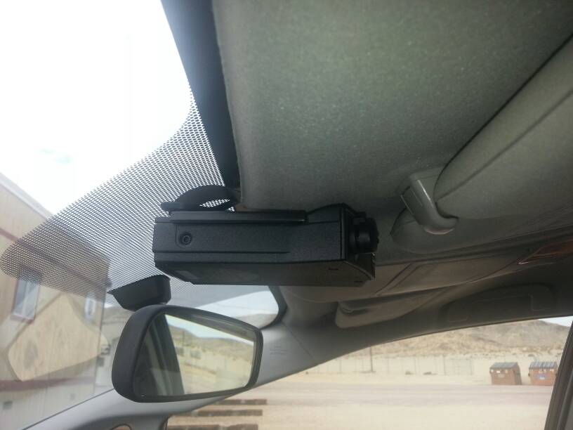

    Wired to my cigarette lighter so it turns on with the car. Used the cig lighter that is under the center console. Tapped from there and ran wires under the dash and a pillar to headliner.

    Did you just plug it into the cigarette lighter or did you wire into it behind it?

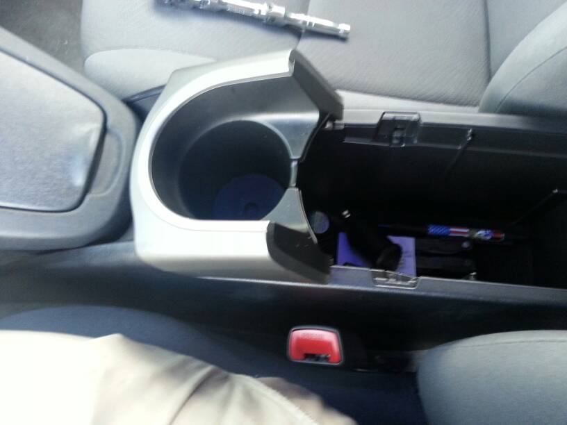

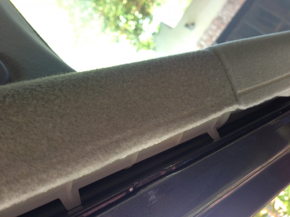

    Easy to do. Wired it behind. If u have the weird cupholder on the center console, you can just pull it up. There are 4 bolts that hold the center console in. I think maybe 5 but its been a month since. It is wired in the a pillar. Just pull the weather stripping off. And as far as headliner goes. Just tuck it in the headliner.

    Is this the weird cup holder in the center console you asked if I had? Are you referring to the one that slides out, or the other one?

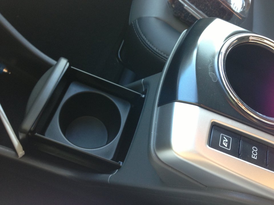

    OP apparently doesn't have a v, so who know what cup holder he's talking about... BTW, our 2012 v Five doesn't have the lower/forward cup holder you show in your photo. Just the chrome ringed holder next to the mode buttons.

    ... BTW, our 2012 v Five doesn't have the lower/forward cup holder you show in your photo. Just the chrome ringed holder next to the mode buttons....our "v" 5 has that lower sliding cup holder and the cup holder is removable from the tray...

    I dont have that as my center console. I just have a regular prius. Mines look like this
    And when you pop the cupholder. You should see the 12 volt wiring behind it.

    I ran the wire tucked in between the carpet and trim/plastic piece to under the steering wheel column, then up under the door weather stripping to the A pillar and up in the headliner to radar detector. Ill post more pics if you want but it will be later today since im at work

    Well whattaya know, there is in fact a pull-out cup holder thereabouts... Thanks!

    Also, I did not take the A pillar apart. You can tuck the wires in just by pulling out the weather stripping. If you were heading up to vegas, victorville or barstow anytime soon I can install it for you.

    Ok. I see where I can tuck it in alongside the weather stripping which is great. Perfect! How did you get it from the weather stripping to the headliner withouth having it go back out and across the A-Pillar?
    Also, do you have an airbag in the A-Pillar?
