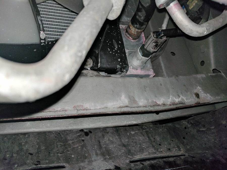

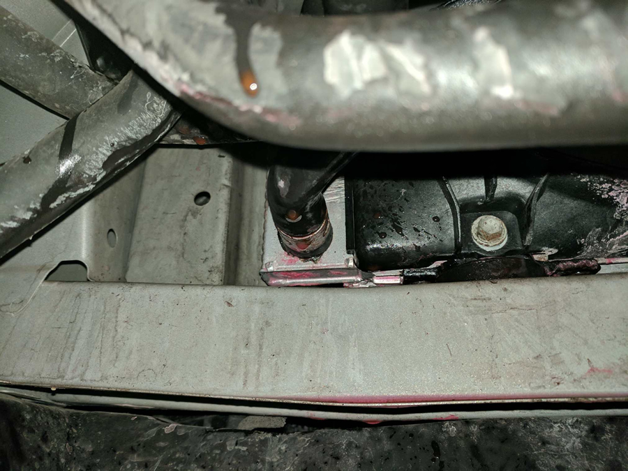

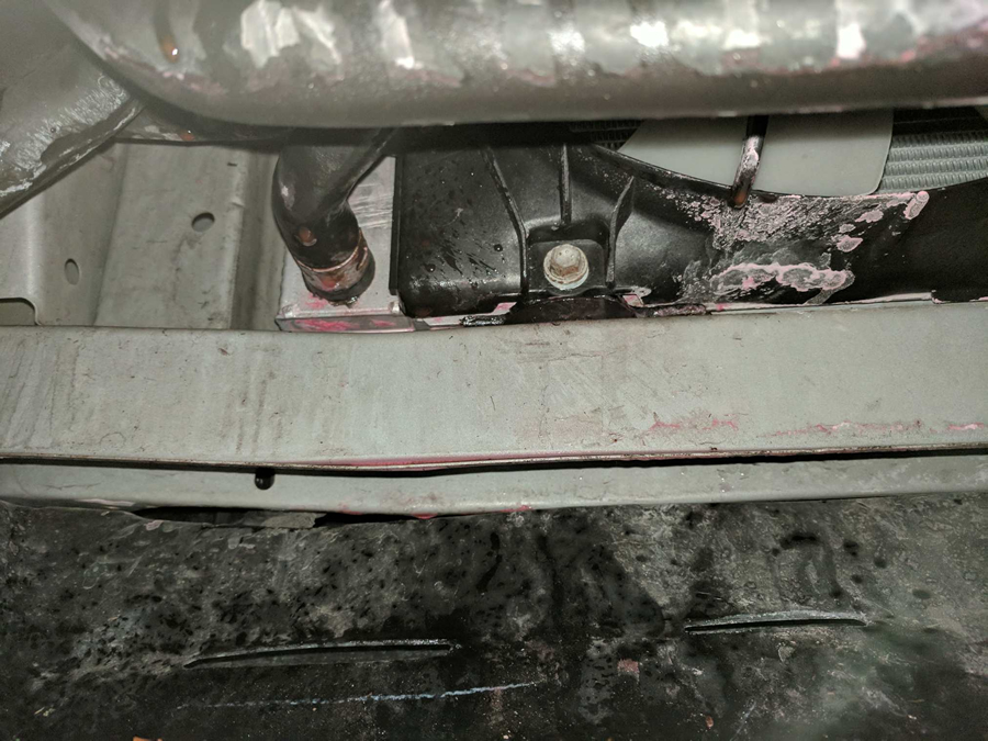

    My 2005 was in an accident.
    As part of the repair the private shop replaced and installed a new cooling radiator.
    This is the same car referred to in thread
    Hybrid Battery Filter | PriusChat
    After the repair, warning lights about overheating kept coming on. The private shop claimed the hybrid battery compartment had to be cleaned out. Which they did. Then 155 miles later the problem reappeared.
    Took it to the toyota dealer. Besides finding more debris in the hybrid battery compartment, and no filter put there, they also discovered that the shop had installed the hoses to the radiator incorrectly, resulting in leaks and debris within the radiator, so they flushed the radiator and installed the hoses properly.
    Private shop claims they installed hoses correctly and that there is no signs of leaks.
    Bottom line private shop never got the car working properly and claimed nothing was wrong with it.
    We showed them pictures of the hoses and the evidence of coolant spills. They claim the picture show the hoses installed properly, and if they were installed incorrectly you should see liquid leaking out. I told them that only happens under pressure when the car is on.
    Look at the attached pictures and see what you think

    hopefully these photos will work from an album I uploaded
    [​IMG][​IMG][​IMG]

    From the pictures you can only tell that has been leaking. But you can’t tell from those pictures why it has been leaking.
