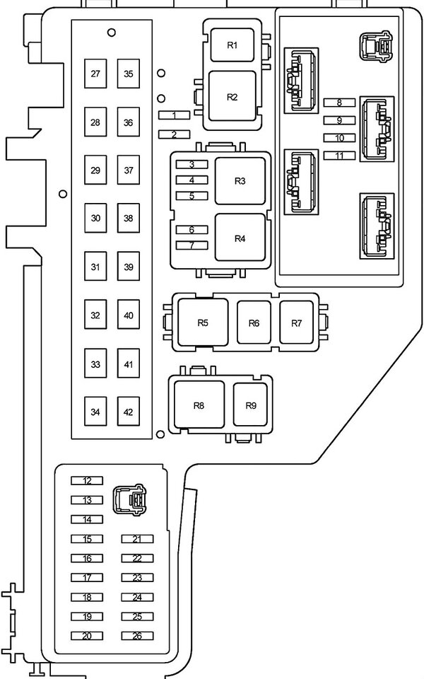

    • Replaced three fuses that feed the audio/MFD/clock circuits (all tested good for continuity despite the old blades showing oxidation and heat discoloration):
      1. Engine compartment #17 DOME, 15 A
      2. Passenger-compartment #17 PANEL, 7.5 A
      3. Passenger-compartment #24 ACC, 7.5 A
    • After replacing, I cycled the engine and door locks twice (to mimic leaving and returning)—the radio stayed on. I’ll report back if it still works tomorrow.

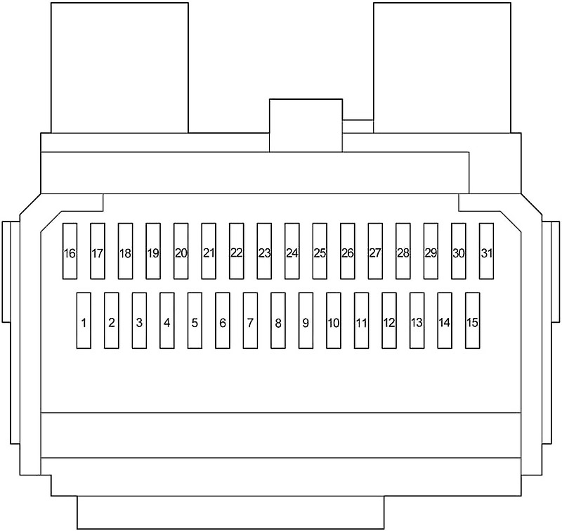

    Related Fuses
    Engine Compartment 17 DOME 15 A Audio system, interior lights, smart-entry/start, gauges, turn signals, luggage light, clock
    Passenger Compartment 17 PANEL 7.5 A Multi-information display, clock, audio system, instrument lights
    Passenger Compartment 24 ACC 7.5 A Audio system, multi-information display, clock
