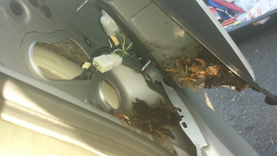

    We had few days of heavy rain here in California a week ago and I noticed while cleaning my trunk a small water puddle under the left black plastic tray nearest the left tail light. I traced the source of the leak from the back of the taillight assembly. Curious as to what's causing it, I removed the tail light and was surprised to find a pretty significant amount of mud, leaves, dirts etc. accumulated over the years, fully clogging the path of rain water down to the bottom of car and causing water to seep and find a way into the car's interior. See attached picture. This is a bad design of rain water drain path 20150214_082752.jpg for this 3rd gen prius. That means 3rd gen owners have to remove and clean the space between the tail lights and chassis every few years else we will end up with flooded trunk. Just sharing the experience...

    i can see the water, but leaves? makes no sense.

    Enough of leaves have collected behind and bellow headlight to stop water from flowing out of there. Then water did just get into the car through light assembly gasket.

    Open up the hatch. Look at the rain gutters on each side of the hatch. On my Prius as they flow to the rear they disappear under a piece of plastic adjacent to the tail light assembly. When smaller leaves/trash falls into this gutter it can disappear into this trapped cavity area. I have seen leaves disappear & always wondered where they went - seems I just found out. Now to check it - later :)
