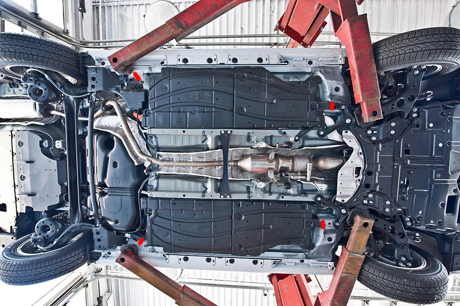

    Thanks Mike, but I gave up on those points, trying to make them work. I found four solid/heavy points, nearby. In this pic the front of vehicle is to the right side.
    The red bars are where I'm putting stands: front locations are just at the end of a structural body rail, and rear locations are in middle of convex thickened area.
    Note the little oblong plugs in vicinity of rear points. Pulling those out reveals a heavy gauge opening. The whole area appears to be a strong point. On our car one of the plugs was missing. When I picked one up at dealership, they told me those plugs are dealer-installed at Pre-Delivery Inspection, and they speculated during shipping some pins go into those slots, to prevent the car from shifting around during transit.
