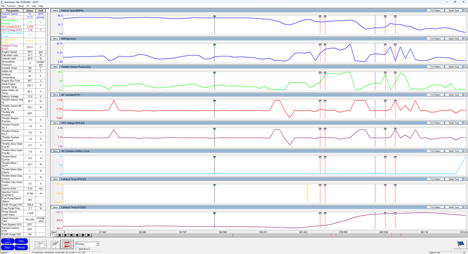

    I was able to take it for a longer drive and it didn't strand me, so...
    Techstream data is uploaded, with points where I went heavy/full throttle flagged. It didn't die or sputter or anything, but definitely felt low on power compared to normal. Also adding a screenshot for those without Techstream, assuming PriusChat doesn't nuke the quality.
    Also disregard the previous reply about the cat being nonexistent, I was thinking of one of my other Gen 2's. So that's still a possibility.

    I just looked at the latest 5+ minute data file. I did not see anything to jumped out at me.
