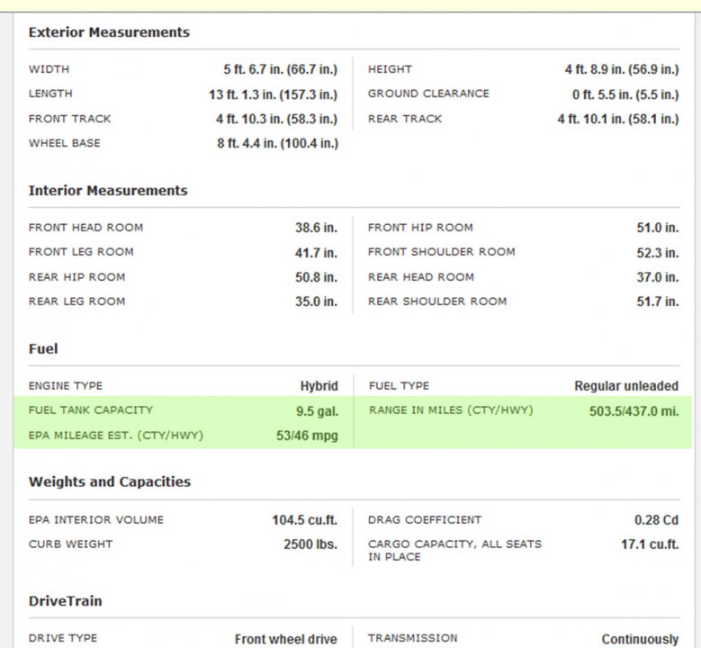

    E: The tank is rated at 9.5 gals.

    No its a Prius, not a Prius C, I know that one is ~9.5 gals, that's why I did not get it. It would only give me 3 days range (the same I could get from the Corrolla for less with better incentives)
