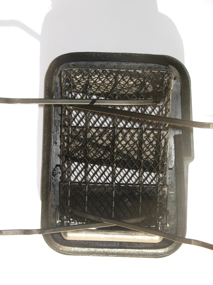

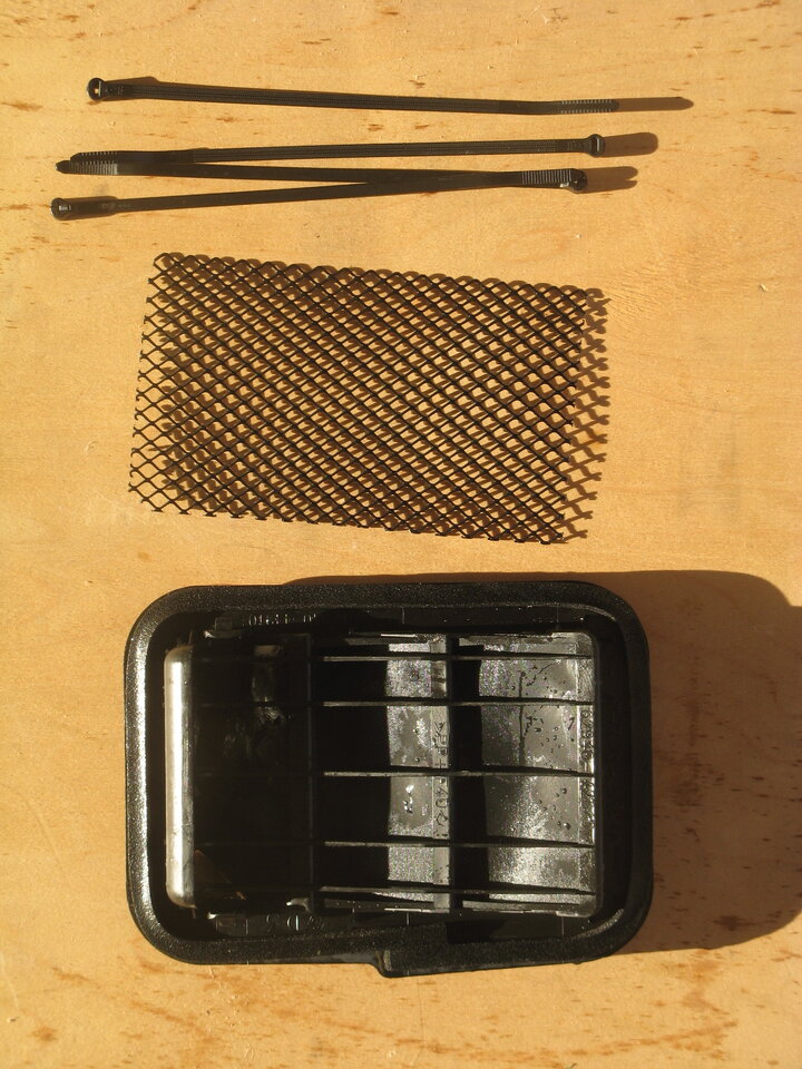

    Here are photos of how I attached the rodent exclusion screens to my rear air exhaust screens.
    The screens are cut from inexpensive expanded steel mesh gutter guards sold at Lowe's or Home Depot.
