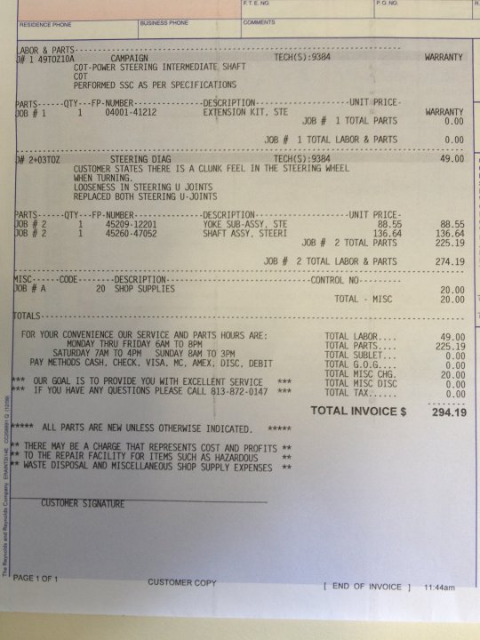

    Just had this same problem on a 2005 with 143k miles. I took it to the dealer because it had an open recall for the steering shaft anyway. I knew this wasn't the problem but I figured I might be able to get a free diagnosis. They replaced the steering shaft assembly (part # 45260-47052 $136.64) and the steering yoke sub assembly (part # 45209-12201$88.55) and only charged me $49 diag and $20 shop supplies because they were already in there doing the recall. It didn't hurt that the advisor is a friend of mine and I have a wholesale account with the dealer for parts. The total for the repair was $294.19 (I am tax exempt).

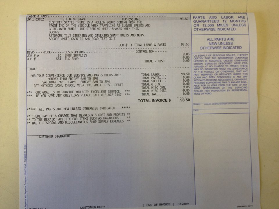

    Taking another one to the dealer for same problem as previous post #26. It fixed the problem last time. I will let you know how it turns out.
  14. TampaPrius.com
    TampaPrius.com Active Member
    Feb 20, 2013
    461
    300
    Tampa, Florida
    I was able to have this one fixed for $98.50. They just tightened a few bolts and noise is gone. I will try that myself next time. IMG_8403.JPG

    Looks like you found an honest dealer. I'd appreciate a PM telling me where it is.
