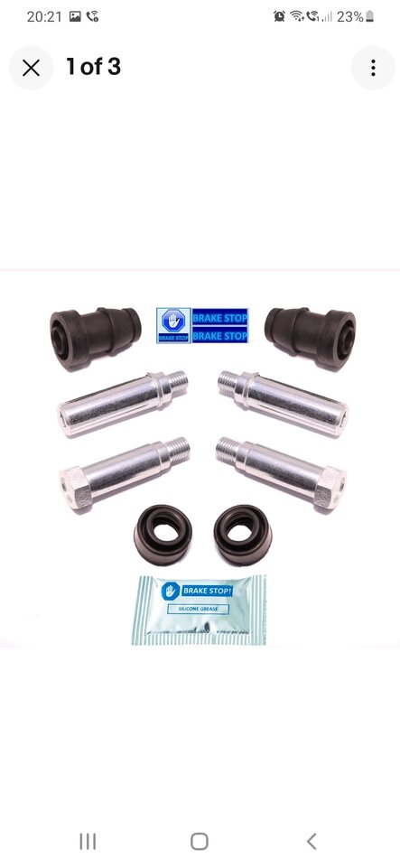

  11. james909
    james909 Member
    Aug 10, 2015
    107
    Leeds, U.K
    You could be onto something there. I had the pads changed in July and I don't know if that's when the noise started. This is what I've seen on eBay. Screenshot_20251122-202109_eBay.jpg
  12. Mendel Leisk
    61,502
    42,317
    Looks like you're missing the lower bolt, through the caliper ear and threading into the slide pin. They forgot something on hat recent brake work?
  13. james909
    james909 Member
    Aug 10, 2015
    107
    Leeds, U.K
    As far as I know it's one piece that's the bolt/pin. The play is about 5mm. If it was not there at all wouldn't it just lift off at that end.
