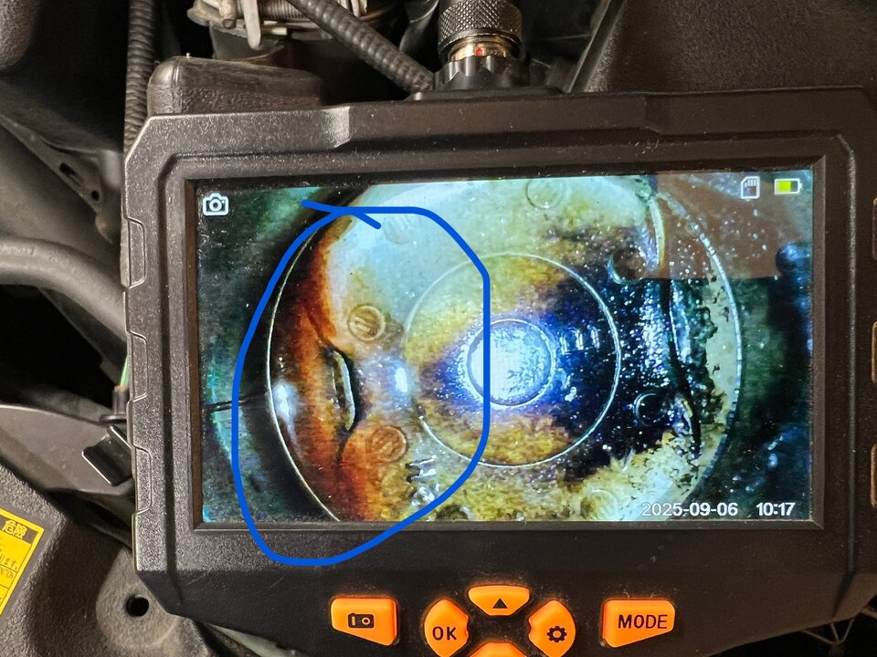

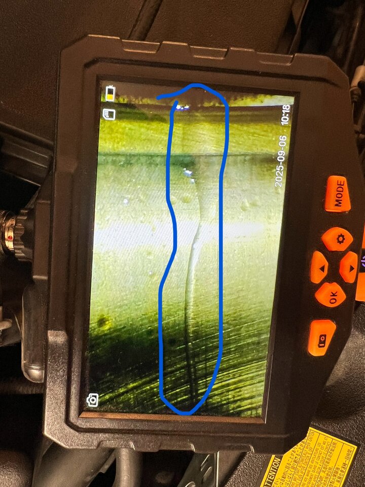

    Your mileage and symptoms point to classic Gen 3 head gasket failure. You need to use a borescope to check for coolant leakage into cylinder #1 and #2 while the cooling system is pressurized. Search this forum for much more information on doing the borescope inspection.

    Exactly. Almost too common to count. Oil is rarely if ever contaminated, combustion gas coolant test will pass as will leakdown or compression tests.
    The real question - is it an oil burner as well. With the right vin you would have revised pistons and rings reducing oil burning. If it's an oil burner a rebuilt engine is the best solution.

    The Prius lost ~1“ of coolant in just 2 days driving.
    On Saturday I rented a coolant pressure pump from my local auto parts store and put a camera down each cylinder.
    Cylinder 1 surprisingly had carbon but the plug was soaked and there were visible oil drops all along the cylinder walls. When I added pressure to the coolant tank you could see a stream start to come down the wall and pool at the bottom.
    At the top of the cylinder near the gasket it all looked soaked.
    Cylinder 2 and 3 looked normal and dry.
    Cylinder 4 was dry from what I could tell, but the piston head looked really clean as if it was coolant washed but I couldn’t find any evidence of coolant.
