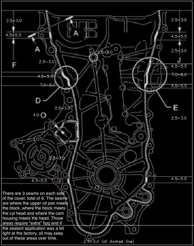

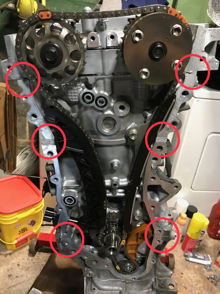

    Good pricing on the timing chain cover. Most of the time they just seep which is not enough to see on the dipstick.
    By the way the timing chain cover has no gasket in a traditional sense like the intake, it is all sealant. The engine design has horizontal seams in several places under the timing chain cover where the sealant fails. There is a small gasket for the tensioner.
