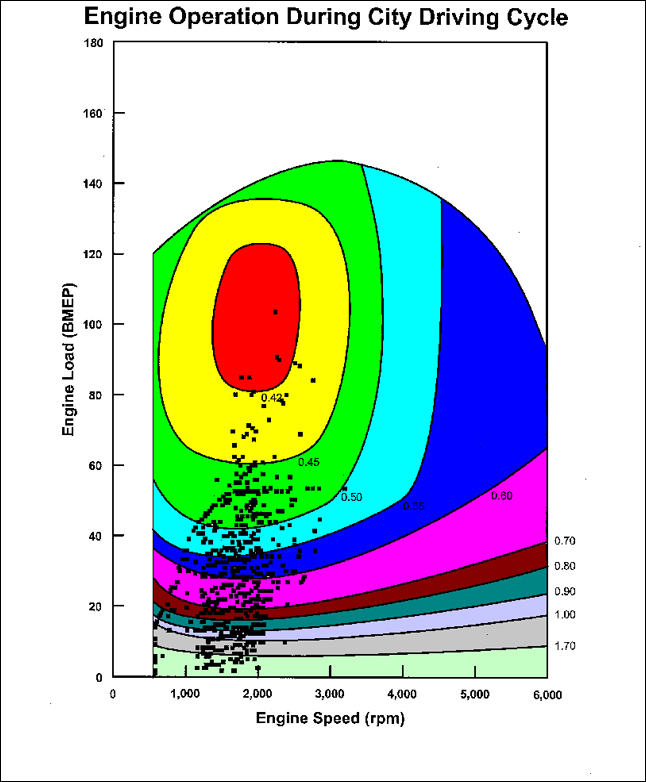

    So, first thing to note is that peak efficiency is lower, and the peak efficiency range is much narrower. In this case 1000 to 4000 rpm at the most efficient torque varies more than 11% from peak efficiency, with the 5% window only being about a 1500 rpm window "if" you could just simply move left to right on the chart near the peak efficiency torque as the Prius mostly does. Second, you have fixed gear ratios so there is a fixed relationship between speed and rpm in a given gear. At a given speed you can only move left to right on the chart by changing gears in fixed steps. As you press on the gas, you can only move up and down the chart vertically. I believe all of the points on the chart refer to a single speed condition, at various gears and throttle levels. So you can see trying to hit the sweet spot is a lot more tricky. You can also see that with light loading, even at steady flat highway speeds, if your final drive ratio is too high you tend to end up in the bottom right quadrant of the chart. This is a very inefficient place to operate, and can put you at 50% of peak efficiency or worse.
    This is why overdrives made such a difference on the land yachts, pulling the highway cruising operating point back up and to the left toward peak efficiency. You'll notice that on the Prius, this area does not really exist as a valid operating region on the BSFC map. Unless you are driving under conditions that routinely put you over 4000 rpms on the ICE, the impact on engine efficiency is going to be pretty small.
    I think you can really see how all this comes together when you look at the following plot, which shows the toque / rpm location on the bsfc map for a Saturn 1.9L through the duration of the city driving cycle test. As you can see, in a real life-ish driving condition the engine gets to spend very little time near peak efficiency.
