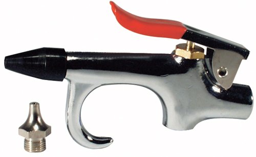

    You can also just use an air gun like this, set your regulator pressure and hold it over the hole to test the valve.
    Totally agree with John, be very careful because if one lets go you could be badly burned, I would drape a crappy towel on top of it all just for extra protection in case you do get anything released during the test.
