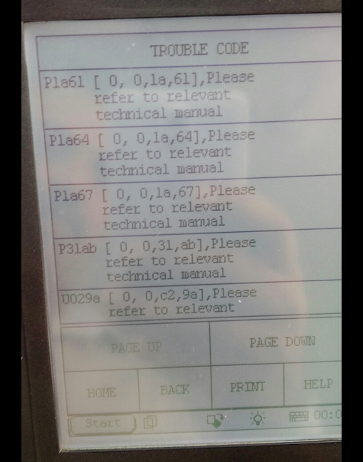

    My car is 2012 Plug in ,, got from Japan , presently am in Pakistan, here the dealer ship do not have adequate back up.. how ever ...3 moths back ,,the car suddenly stopped ,,, and the message was ,, CHECK HUBRID SYSYEM and park the car at same place which came on the dash board display,,how ever on the diagnostic computer the errors came which i am attaching the file below, a local car mechanic suggested me to replace the charger assembly G9090-47040, which i did,, but unfortunately the car did not moved to READY ... i have an idea that my traction battery is not charged .... but the issue is that once i plug in the charger ,,, the amber light beside the charge in let in the car blinks 10 times,, and goes off ... really un certain ,, what to do ,, kindly suggest and help,,

    Latest codes , are same even after replacing the charger assemble ,,,, which are attached. the machine which is used is LAUNCH..
    suggest ,,, some other machine for diagnostic ,, which u think ,, might work, please note,,,, that once i plug inn the charger in the chaging slot in the car the amber light ,,,, which is supposed to be continuously on ,,, blinks 10 times and goes off.....

    those codes aren't familiar, i don't know if it's because it's japanese, or the wrong code reader. perhaps someone else will know.you can access the service manual on line by the day. it should tell you what the flashing light means, if it's not in the owners manual. btw, the 12 volt should read at least 12.5, after it has been off for 8 hours and with nothing on in the car. we open the hood in the evening, and put a voltmeter on the jump point in the morning for an accurate reading.I don't know what is involved in replacing the charge, can you recheck the connections?
