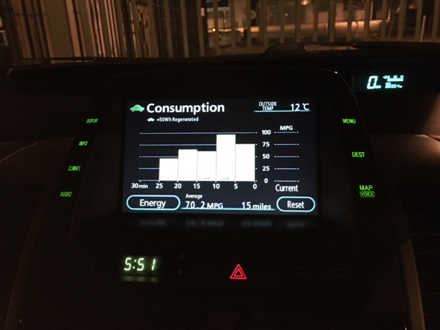

    Talking about ethanol free fuel, I filled up at my local ESSO Garage this morning, on my way to work. The attached picture shows my MPG for the 15 mile journey from the Fuel Station to where I work.
    I noticed rather quickly during the journey that my MPG readings seemed higher than usual for every section of the commute.
    The temperature was 12c. I used cruise control to keep to the speed limits for about 3/5 of the trip. I also switched to manual throttle control when going through 2 underpasses, using the gravity wells to swing me out of the dip with mpg no lesser than 70mpg coming out of the underpasses - achieved by also feathering the throttle.
    I got to work to find 70.2mpg on the MFD.
    It was 70.4mpg by the time I'd parked inside the car park at 5.55am.
    I've never seen figures like this for 15 miles to work before - and certainly NOT at 12c temperature. My MPG before fill up was 56.1 @ 512 miles (filled up with 42 litres).
    My only explanation for this is that somehow, the pump I filled up from must have had ethanol free petrol in it.
    Throughout the journey, I noticed the MPGs rise rather quicker than usual and stay at higher levels than usual.
    I can't think of anything else that might have caused these unusual readings.
    Explanations are most welcome :)

    Gasoline can vary in energy content (density) and of course ethanol content. Especially Premium could be very high energy content if it stuffed with high density aromatics. In the US I am expecting 10% difference between the lower energy content fuel and higher energy content fuel. It is not guaranteed that Premium has more energy, it is just a possibility depending on formulation details. What I do sometimes is get exactly 1.5-gal is a red plastic gaso container and go hone and measure weight right away to get density. In the USA, the aromatics are regulated by EPA so that reduces energy content.
    When measuring MPG, I believe EPA uses density of test fuel mathematically to adjust observed reading to a constant energy content (direct multiplier).
    The fact that Prius is so clean re: emissions makes me wonder if EPA's aromatics restrictions (and ethnaol dang it) are unnecessarily hurting MPG - which we can see so well in a Prius
    50 MPG we want to see maybe 60 these days
