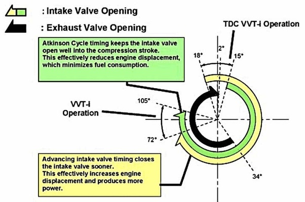

    The compressions ratio is about 9.5 to 1*, the expansion ratio is 13 to 1. Otto Cycle engines do not have two different ratios, but Atkinson Cycle engines do.
    * the timing of intake valve closure can be adjusted, so there is no hard 'compression' ratio, but It can't be adjusted to 13 to 1

    The Prius has a theoretical 13:1 compression ratio, but it's actual ratio is much lower than this "about 8.5:1" because the inlet valves are kept open at the beginning of the compression stroke pushing air and fuel back into the inlet manifold. This means compression does not start at bottom dead centre. This is the reason it's called an Atkinson cycle engine. An engine with a shorter compression stroke than it's combustion stroke.
