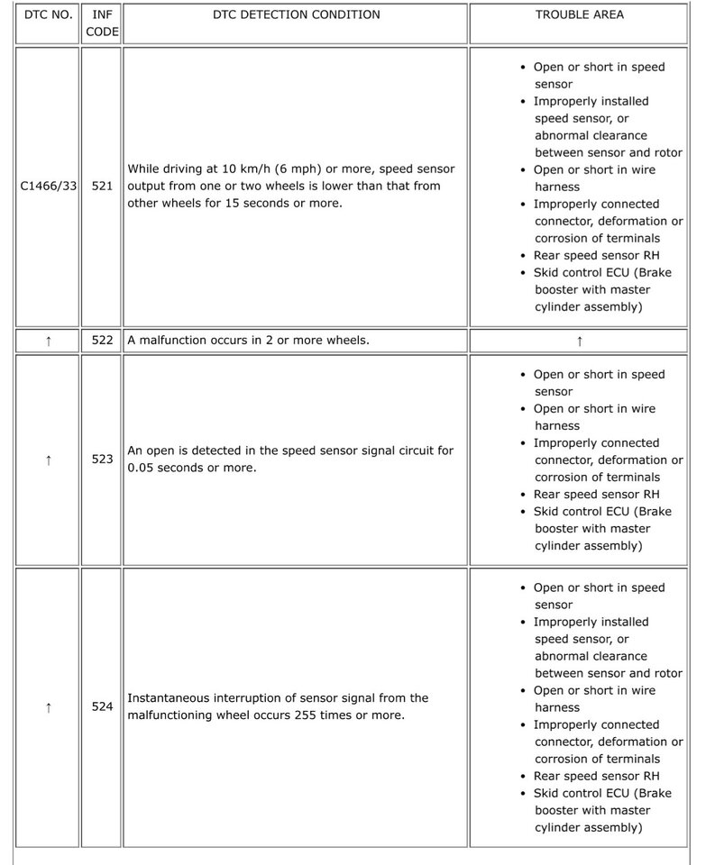

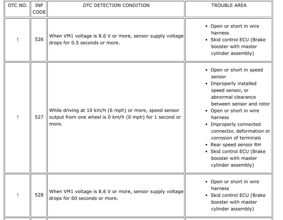

    I would get a copy of Techstream and a mini-vci to actually narrow down which c1466 code you have even though the hub is typically the "normal" problem.
    Your situation may not be "normal" because you changed your oem hub for noise and then got the code. If a mechanic did this, you would probably blame the mechanic.
    Or you could do the blink code jumper trick Chapman has been asking you to do.
    While the hub failure is typical, many have damaged their harness in the past. Some in ways which were not visually obvious but were diagnosed with a meter. A few shade tree wrenches with good soldering skills have achieved a "no parts required" repair on a bad harness.
  16. ChapmanF
    28,636
    18,959
    The blink code jumper "trick" doesn't give you INF codes, though, so you'd still be wondering which subcase of C1466 you've got.

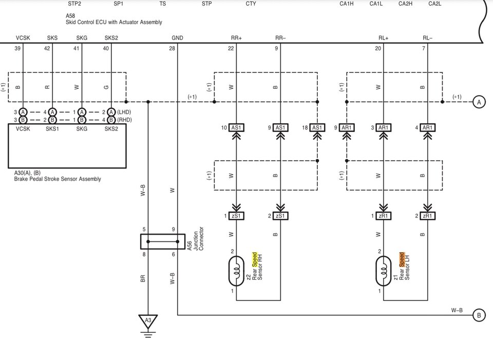

    Here is the thing: It is 99% in the exposed part of the harness that flexes near the wheel. That part of the harness is two wire non-shielded - an easy solder job for any teenager who ever used a pencil soldering iron. For me this would be a ten minute job but it would be important to first find the break and simply repair it - eg no parts required.
    In the diagram above, the hub connector pins are labeled 2 and 1 vertically next to the sensor.
    Pic from my v years ago when changing the xm satellite antenna preamp.
    The cable from the hub enters the cabin as shown. The connector zS1 is above this near the hv battery, at least in a v. It takes some panel removals to get to it but that's what you need to do to replace the 2 wire harness from there to the hub.
