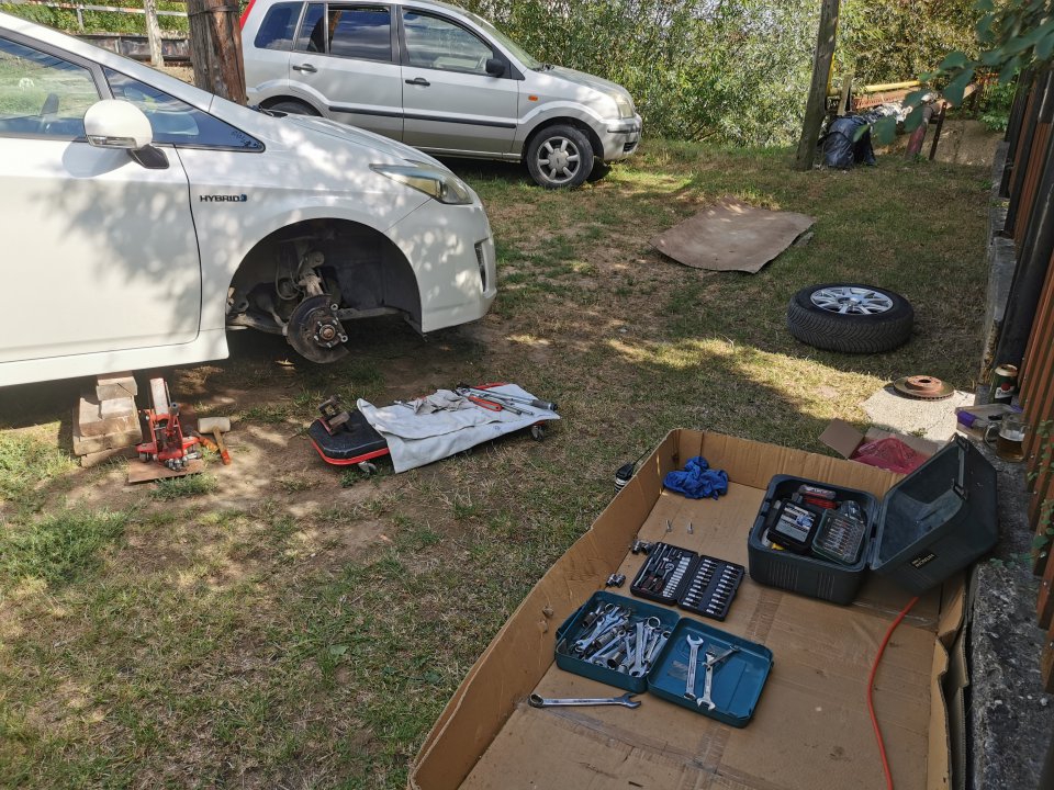

    Two weeks ago I went to my brother in law to change brakes. All of them. Rotors, pads, shims, plates, lubricate pins, all that jazz.
    All parts are Toyota except front rotors which are ATE because half price ($100) compared to OEM.
    Start job
