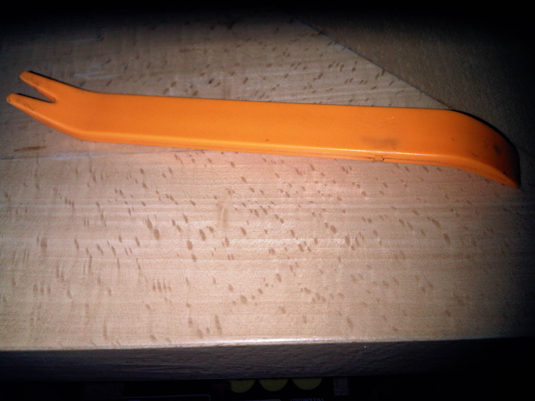

    No idea about the lock issue as I don't experience that. Maybe the cleaning with Wd40 and apply the carbon based grease will helps.
    The rear hatch door's plastic panel is easy to remove. Simply pry with a proper tool along shorter sides of the panel, there are small openings on each side which will help you. There no bolts, just plastic clips around panel's edges. Altogether about 10 of them.
    The plastic pry tool is a basic tool to maintain your Prius. The pry tool I use:
    http://priuschat.com/photos/img00061-20130420-1932-jpg.10526/standalone

    I understood his question as for rear hatch door. So my writing is for that door. I updated my original post.
