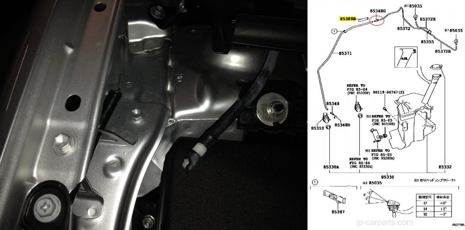

    Argh... it's happened to me now... rodent damage! It/they attacked my washer system in multiple places. I can't be sure of the exact timing but it appears I discovered the washers weren't working around the same time they did it. At first it was simply that the windscreen jets were not operational.
    I had been away for a month in June/July and it wasn't until a few weeks later that I had an instance where I went to use the washers. I had forgotten that I normally avoid using them at night because with the headlights on, the headlight washers are used as well. The headlight washers serve no purpose at all other than to leave spots all over the front of the car... but on that night the illuminated water fountains told me that part of the system was working. I also tested the rear washer successfully.
    Looking in the engine bay I immediately saw the problem. Clearly there's a break around the hose joiner, but also there's clearly bite damage with holes on the underside of the upper hose. I don't know if the diagram on the right is accurate for my model (it comes courtesy of Google searching) but if the part marked 85389B is meant to be there, there's no sign of it now.

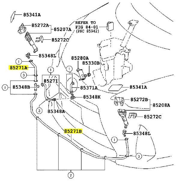

    I also noticed the level of the washer reservoir was far lower than normal. I normally just keep my windows clean and rarely use the washers. I refilled it, but soon discovered the car was leaking washer fluid, taking about 5-6 days for the 4.7L to leak out completely. I was about due for a service so I waited until last night to refill the reservoir before taking the car in today, but by the time I got home from the service station where I filled it, it was already empty again. The official verdict was that as well as the above, they have to order two hoses marked below (from the headlight washer system) from Japan. They're not expensive, but I'll have to wait about three weeks.
    I guess I can be thankful that they chose to gnaw on a non-critical system... I just hope they/it is actually gone now!
