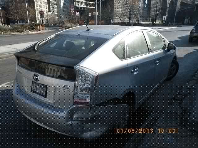

    Hi
    Pretty straight forward situation. Was rear ended on the highway in NJ by someone. Their insurance turns out to be crap so I have to go through Geico (mine) to get the damage covered. Then Geico goes after them to recover their money. Of course, I have a 1K deductible which is really annoying considering I have no fault in this situation.
    Anyhow, what i will most likely do, meet tomorrow with the Geico person who will evaluate the damage and cut me a check. Then I will try to find auto body shop (decent one though) which will hopefully agree to fix my car for a little less so I don't eat the whole deductible.

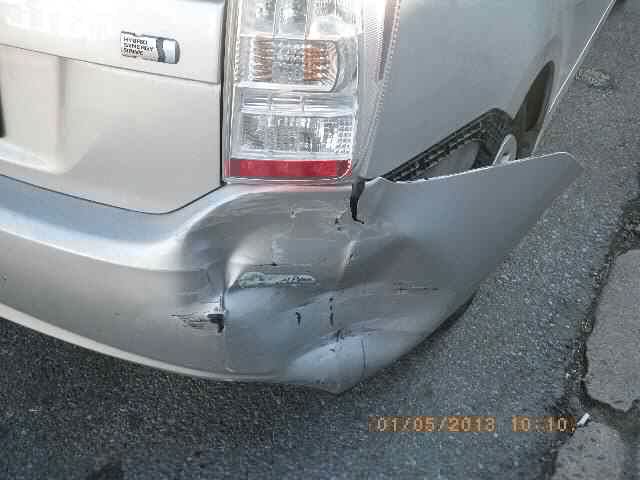

    My main question is, from the pictures and from you experience, considering that the Prius has a lot of computerized parts and sensors in the tires, etc - do you see a possibility of there being more damage then it shows?
    - Bumpers definitely needs changing
    - There is a gap between the back of my right rear light, and that side section of the car - from the impact or from the bumper pushing on it. Would that need changing or could it possibly be pushed back to fit nicely behind the light again?
    - Are there any possible other damages underneath the bumper I am not seeing?
    Thanks for taking the time to look!

    I would take it to a good body shop (ask friends/neighbors who have collector cars) which is approved for use by your insurance company and let them work it out. The shop will carefully inspect the car and provide a full estimate to the insurance company. There is often hidden damage that is not seen until they take things apart. A good shop will also do careful paint matching so the repair is not apparent.

    Someone mentioned hidden damage - typically the adjuster will write up the repair but once the body shop is able to pull the car apart they will handle it from there. If there is additional damage they will get an authorization from the insurance company. I had this happen to me, it was a fairly major issue and the adjuster went back to inspect it. It was all handled by the body shop and insurance company with no muss or fuss, the only issue is it added a few days to the repair.
    I went through it just after moving to PA so I just went to the local dealer - I figured that they would be as good a choice as any and also would also be the best folks to handle it if there were any funky hybrid issues with the car. I had a terrific choice - the body shop was terrific even though I have had pretty poor experiences with the dealer itself.

    That looks bad. 1k deductible is a lot but the damage is a lot more, IMO.
    I had a small bump, just a paint scrape but the their car went under my Prius that did damage and the insurance gave me a quote of 1140.00. Half was labor the other half was all OEM parts.
    Make sure the exhaust system is included. That pipe and hangers go all the way to the front and that could be all crinkled, I suspect. Also make sure they cover the collapsible white foam in the bumper.

    Do you see any visible damage inside the vehicle? Remove the triangle false floor cover over the aux battery. I would actually remove the whole false floor. It is really easy, the same as if you were changing a spare tire. Take out the 2 corner triangles, unlock the main cover, that folds up and slides out. The crap-storing-tray just lifts up in full. That should give you a clear view.
    The 12v battery vent is down there. And as someone mentioned the exhaust is awfully close to that.
    Usually you are surprised by the amount. I would suggest not having the insurance agent just write you a personal cheque now. Take it to a body shop, have them work with the insurance company. That way you only get billed your deductible and the body shop and insurance company fight over the details. Otherwise you are going to be in the situation to resolve issues, and there will be. If something new is found, or they have to respray that side to colour match, I would rather have the body shop tell the insurance company that and bill them, then to bill you and have you ask your insurance company. That will then spin off a new claims agent looking at the car, blah blah blah.
    And not to mention that any money over the amount you collect from the insurance company not put towards repair with your full deductible is insurance fraud...

    In my not-expert opinion I think you'll find more than bumper cover damage.

    My Prius was hit hard and a bit higher than what yours was and they had to replace the exaust, floor pan, piece of frame and the works. A lot of stuff can get bent that an appraiser won't see. It's all good and well they want to come out, but take it to a shop after.
    Take it to an approved shop if they have some, in the event there are repair issues geico will have to help you follow up with the body shop.
    You'll most likely have to go after the individual themselves for your deductible, as well as for the diminished value. I bet its about $5k all together they will owe you, small claims court would be best and you wouldn't need a lawyer.
    I'm gonna guess that as long as the rear floor pan isn't bent, and as long as your gaps inbetween your passenger side doors aren't off (there is no frame damage,) repairs will be in the $6k-$8k range. Possibly lower if they managed to miss anything vital.

    Anyhow estimate went ok, so far is around 1.5k but they warned me it will probably be more after they take the bumper out (Thursday) and look for more damage. The initial and obvious damage so far is as follows: Rear Bumper Damage, Right Quarter Panel Damage, Tail Lamp is fine but could be damaged inside, so they will change it anyway, Exhaust pipe looks fine, but they will look it under in more detail when they get the car.
    The damage doesn't really seem like the end of the world and the shop I went in has a shit ton of great reviews on Yelp so hopefully they will do a good job. I am really more irritated with the fact that people are allowed to drive in various States with crap insurance and then basically create all this shit for other people who are obviously not at fault. But again, there are worse things so I will survive whatever the outcome on this one.
