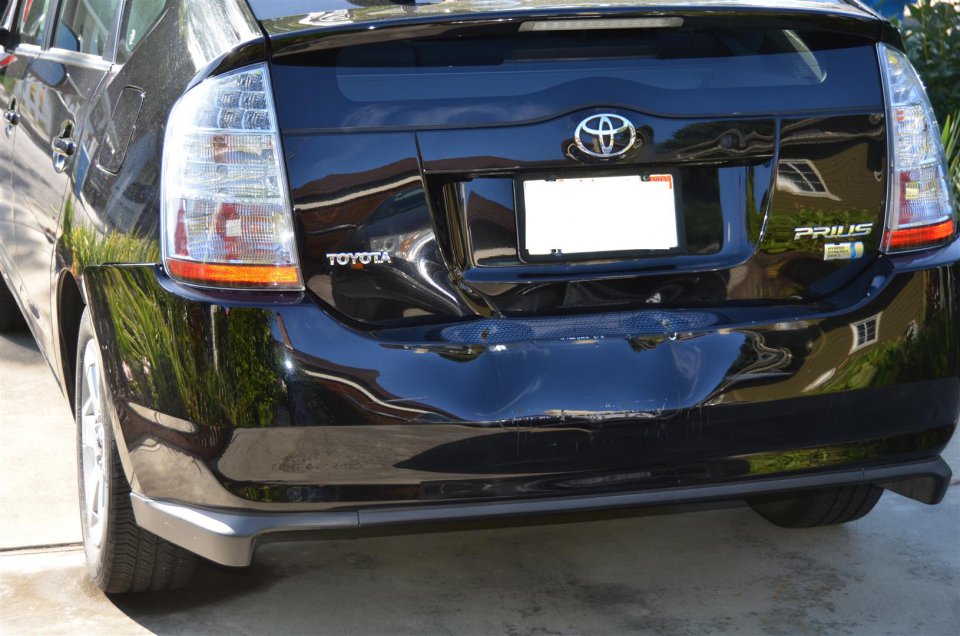

    When we were rear ended a year ago, then estimate was for $2400 - $2700 with the understanding that it could go up once they removed the bumper. Well final repair cost was $5800. My rear bumper was smashed in. See attached photo DSC_0740.JPG
