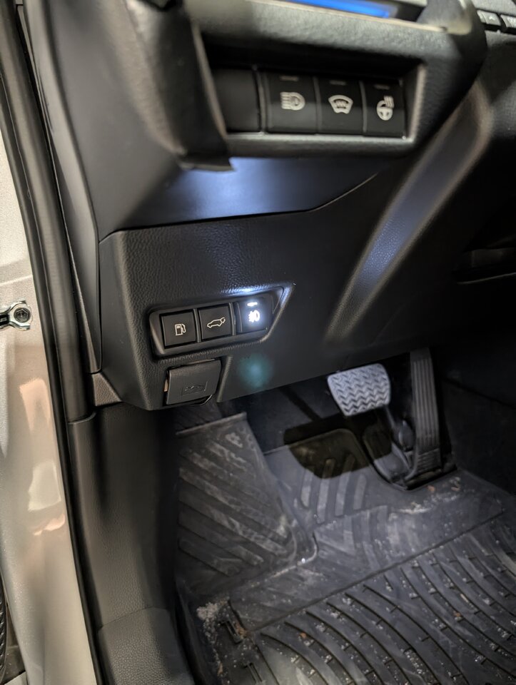

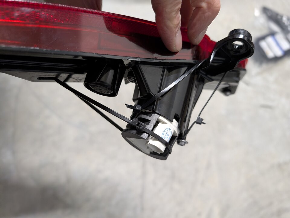

    So here's what I just did to get a EU legal rear fog light on my US Prius in Portugal.
    Overview: I looked into all the options, did not want to buy a new EU bumper with center fog light. I decided to tap into the reverse light area, and found a Japanese aftermarket company that sold a light for around 500$ that turned the red reflectors into a light. A bit expensive, and I didn't want to wait for shipping so I made the decision to replace the rear backup light with a fog light.
    Problems & Solutions:
    - LR5B (Red) led was slightly different that existing L1b/LW5B (White) led. You'll see that I used zip ties to keep things secure. This is because the notches on the light are different
    - LR5B led harness was impossible to find with shipping to Europe, and seems hard to find regardless. So I cut the existing LW5B harness with female connector, and filed down one side to get it to fit the LR5B led. It's pretty clear what to file down when you have the parts in hard. After that it fit perfectly snug.
    - Had to extend some red/black wires because the fog harness was designed for a front battery
    - I routed the wires from the switch up front all the way to the battery and LED in the back under all the plastic trim, pretty straightforward.
    Next Steps:
    - Right now the button is always lit because it's directly connected to the 12V battery. It's also in a position where my knee could hit it on accident and I could inadvertently part my car and drain my battery by leaving the light on. So, I'd like to wire the fog light so that there's only every power when the car is on.
    Parts:
    - LR5B LED from Aliexpress
    - Fog light harness, any will do but I bought the one with a late-model Toyota button.
    - Solder iron and electrical tape and shrink wrap and heat gun if you need to extend wires or splice cables
    Pictures:
    apissues likes this.

    That bulb fitment isn’t the greatest but love the info and attempt! Could you not dremel the housing’s flange around the bulb socket so the bulb would sit flat against it?

    Can you please provide info on the fog light dash button? I've been meaning to find one to fill one of the blanks on the dash, and add some fog lights to the front bumper. Cheers.
