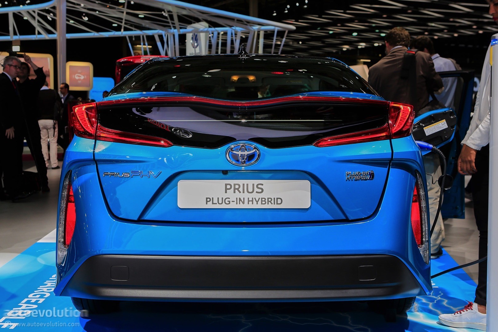

    Where the reflector lights are,
    is there anyway to install rear fog lights are? I feel like there's a possibility to do it. Hope someone knows or can point me into the right direction.

    In Japan and Europe, the rear foglights are indeed housed in the same area as the reflectors; they are small red dots at the top.
    No idea how to install them though.
