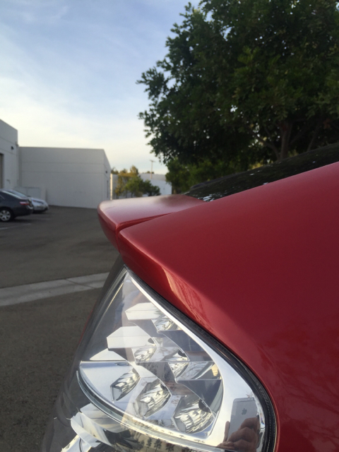

    I noticed that in my car the rear spoiler is not flush with the body of the car, is there any way to adjust it? By looking at it very briefly it seems that the rear hatch will need to sit lower for better alignment - has anyone messes with it?
    [​IMG][​IMG]

    it is possible there might be a little play in the mounting holes on the hatch. if you take the inner panel off the hatch, you might be able to loose the nuts and reposition the spoiler. (while you're in there put some led tag bulbs in)
