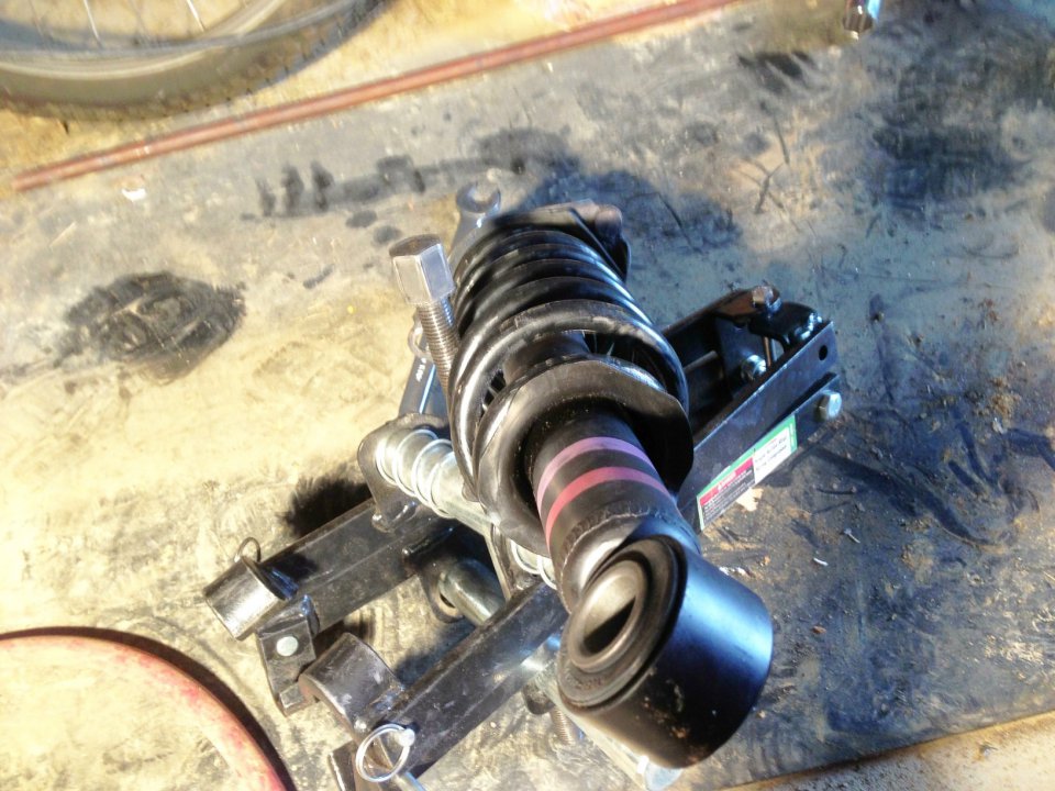

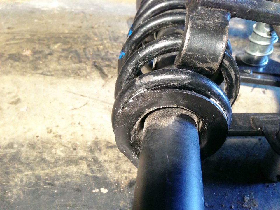

    the bottom of the touring spring has a larger diameter by just enough that the strut bottom plate dimple rides up on the spring

    Yeah I get it the lower spring perch is not nestling the spring right. The end of the spring should nestle right up to the stop edge on the perch. If ill fitted it will make a bang or weird loud noises under load. You should have noticed this
    upon install that it was not fitting right.

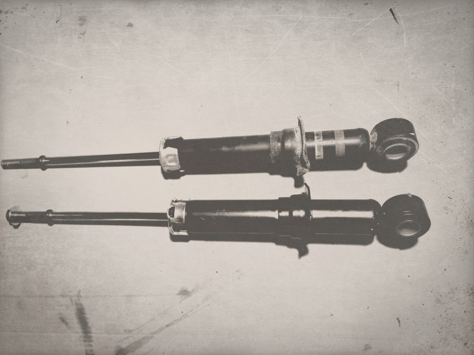

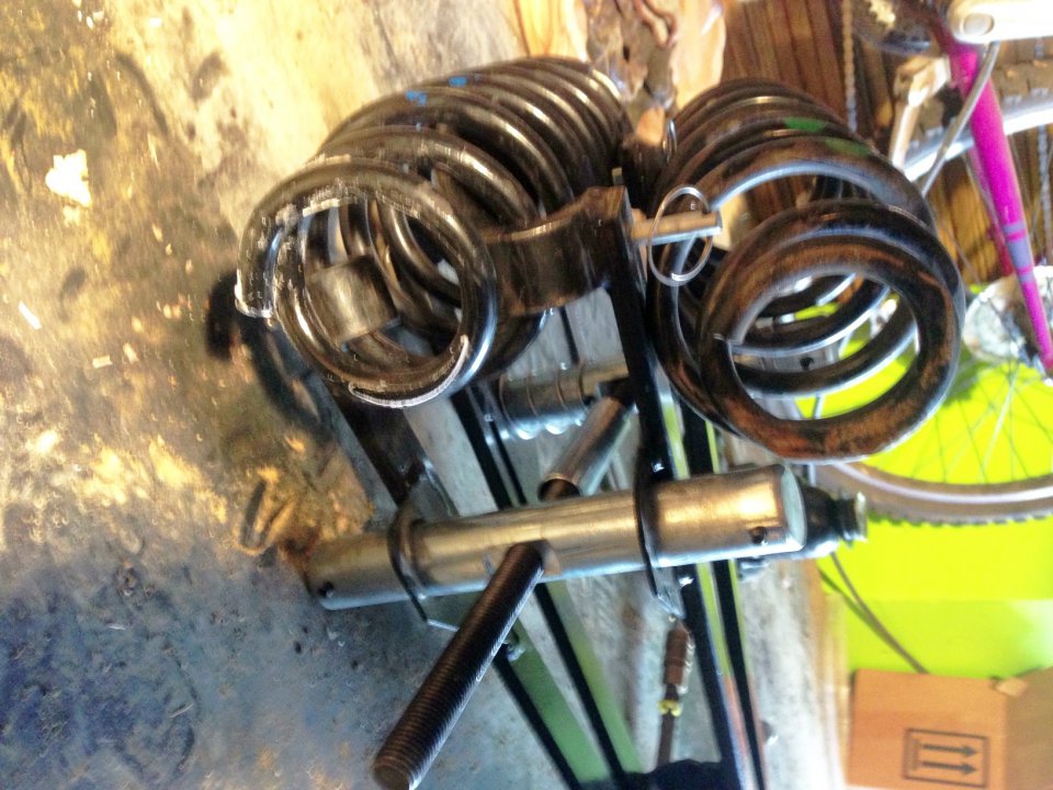

    Got the Toyota struts and put them on today wow what a different's no noises smooth and tight. The perch on the Toyota touring strut is almost square and measures 1/4 inch bigger but the spring fits perfect. I took some shots of the differences.
