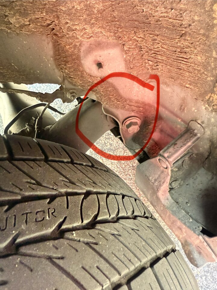

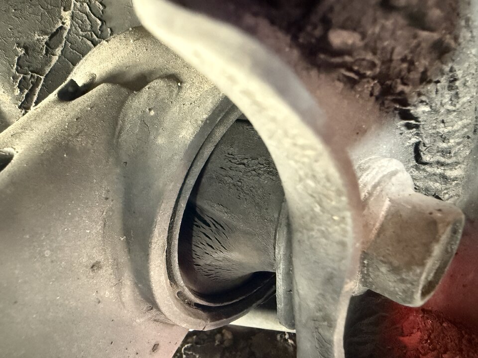

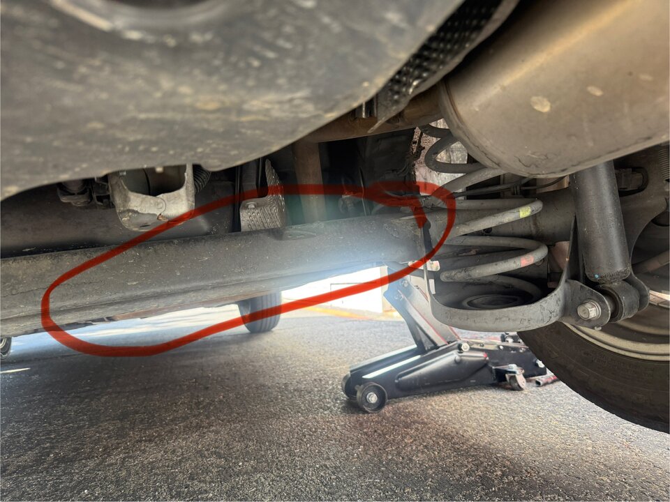

    Tire guy showed me this today; is this piece called the trailing arm bushing?
    I am also running into a discrepancy regarding what these are called. Dealership service advisors seem to want to call these control arms at the rear, and indie mechanics and you all call these trailing arms. Has anybody else noticed this discrepancy?
    The first photo shows the worn piece’s position in relation to tire.
    The second photo shows a close up of the worn rubber on that piece
    The third photo shows the back view of the beam that the worn piece is attached to
    #5 ShihFa, Aug 18, 2025

    Definitely cracking on those bushings, might be the culprit but I’d want to be more sure. Spray with silicone and see if noise changes??

    The first photo doesn't show any wear, that is where the wheel well cover was.
    You can see the threaded stud on the left.
    The 2nd photo just shows normal cracking. Just because it's cracked, doesn't mean it's bad.
    The 3rd photo doesn't show anything except something touched the top of the bar.
    Look above it and see if there is anything in that area that might have hit it, or might still be there
    to hit it.

    Those round circles of rubber can be pressed out and nyce replacements available from almost all bushing makers in various formulas urethane different durometers of rubbers etc they Don't really cost much. Online from places like Detroit Axle you can buy whole arms etc e crappy rubbers already in . Or by the circles of the good shiet . And install . This models really not worth that like AE 86 would be
